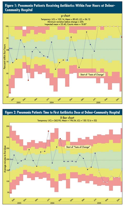

Delnor was similar to many health care organizations struggling to answer the second key question from the API model: "How will we know that a change is an improvement?" Without an accurate way to answer this question, Six Sigma and efforts to improve can be futile and frustrating. To respond, Delnor turned to control charts. The team selected "the average time to first-dose antibiotics" and "the percent of patients receiving antibiotics within four hours" as its two measurements. To provide meaningful pictures of these measurements, the team chose an X-bar chart for the average time and a p-chart for the percent within four hours, as seen in figures 1 and 2 below.
Delnor wasn't short on data, but like many organizations, the data were stored in a variety of sources. Individual pneumonia cases, for example, were kept in the hospital's Microsoft SQL server data repository. CHARTrunner was able to connect to the hospital's multiple data sources, which included Excel, Access tables, Access queries, and SQL, and generate real-time control charts directly from these sources. Once the charts were defined and linked to the data, team members could push a key to see an up-to-date chart at any time, with no additional setup work. With the majority of team members being nontechnical, this ability was not only welcomed but required for efficient analysis and monitoring of these processes on an ongoing basis.
From the charts, the team learned that the average time to first dose was nearly 222 minutes, and the percent receiving antibiotics within four hours of arrival was about 77 percent. But before moving on, the team had to address an out-of-control point on the p-chart. In January 2004 the chart displayed an unusually low percentage of patients receiving antibiotics within four hours of arrival. "Any improvement would be thwarted unless this special cause was identified and eliminated," explains Dr. Carlos Duarte, a Delnor emergency room physician. Upon investigation, the team discovered reluctance by the physicians to use the newly modified pneumonia protocol. This led to delays in treatment because certain antibiotics weren't readily available in the automated pharmacy system at the point of treatment. Through a re-
education campaign, physicians were urged to follow the protocol to avoid unnecessary delays in treatment.
With the special cause addressed, the team progressed to the third question of the API model, "What changes can we make that will result in improvement?" The team created a detailed flowchart mapping out the two sides of the process--patients entering through the emergency room and direct-admit patients. Both flows were used to generate ideas for change. Each of the changes suggested by the subject matter experts was tested on a small scale using multiple iterative cycles of the plan, do, study, act cycle. Some of the changes that proved successful were:
Reordering several steps followed at the time of diagnosis
Eliminating an unnecessary step at the time of chest X-ray reading
Ordering chest X-rays and labs as urgent
Redesigning the direct-admit process
As is common in Six Sigma and other improvement efforts, none of the changes alone created the desired effect. Instead, it was the combination of multiple, small changes over time that led to the significant changes in the two indicators. Starting with the fourth consecutive month at 100 percent in October 2005, the p-chart began displaying out-of-control data points on the high side (which was good in this case). This was a clear indication that the changes had resulted in real improvement. Additionally, the average time to first dose demonstrated real improvement starting in August 2005, with several points marked as special causes. The new average time to first dose antibiotics was now close to 116 minutes. The new percentage of those receiving antibiotics within four hours of arrival was 100 percent, a significant improvement from the initial starting point. Additionally, the average length of hospital stay for pneumonia patients dropped by two days compared to initial levels. This led to gains in bed capacity, cost-avoidance per treated case and a decrease in overall risks to patients associated with longer hospital stays (e.g., those being treated for pressure ulcers, falls and hospital-acquired infections).
"The power of control charts is the ability to let your data speak for itself, to remove human subjectiveness and bias," notes Duarte. He adds that using statistical software has aided in improving patient care. Improvement efforts are paying off. Delnor-Community Hospital is a recognized national leader in patient, physician and employee satisfaction and is one of the few hospitals in Illinois to receive Magnet Nursing designation. The hospital is currently undergoing massive growth in all areas and is expecting to add another 20 patient beds within the next several years.
