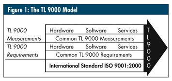

The first major deliverable from QuEST Forum was the development and release of the first and only telecom-specific QMS. Based on ISO 9001, TL 9000 requirements are contained in two handbooks, TL 9000 Requirements and TL 9000 Measurements. The structure of TL 9000 is shown in figure 1.

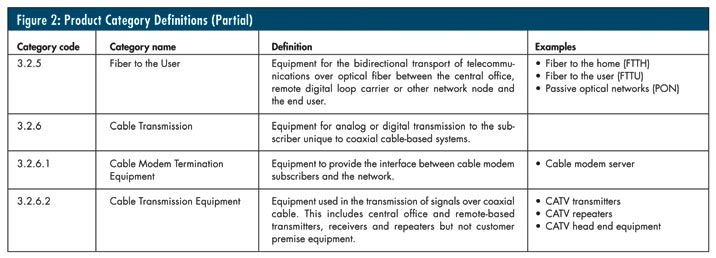

To make registrations and resulting measurements reported to the QuEST Forum comparable, registrations are also classed within product-category families and subfamilies. There are nine major product category families, including switching, signaling, transmission systems (including wireless transmission), operations and maintenance, common systems, customer premise and enhanced services, service, components and subassemblies, and end-user products. These categories include numerous subcategories that make it easy for organizations to determine a category appropriate to its products and/or services.
Product categories are changed more frequently than other requirements to enable firms to suggest added categories should they not find a match for their particular products. Product categories are listed in an appendix to the TL 9000 Measurements Handbook and updated on the forum's Web site.
To illustrate how a company might determine its registration category, an example of product families and subfamilies is shown in the table in figure 2.
This product table provides a category code, category name, description of the product or service, and examples of same. If an organization makes cable modem termination equipment, for example, it would register within category 3.2.6.1, "Cable Modem Termination Equipment." In that way all firms or organizations making similar products are able to benchmark their data using comparable data from similar companies.

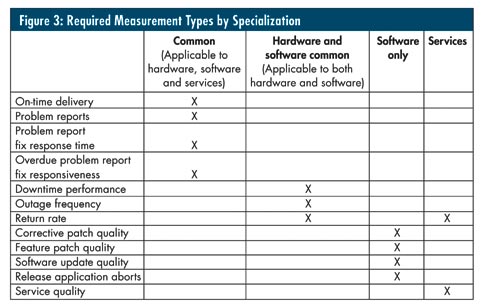

The standard's unique feature is the system of measurements that leads to industry benchmarking and continual improvement. To register to TL 9000, an organization must submit the requisite data to the University of Texas in Dallas, where a blind repository is kept.
Required data depend on what companies produce, as shown in the chart in figure 3 and the product tables in figure 2. These data are available to member companies and allow them to compare their own performance against industry trends to make decisions about product and service quality.

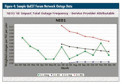

The chart shown in figure 4 below is an example of an actual trend chart produced by the database at the University of Texas for QuEST Forum members' benchmarking activities. The standard reporting format includes:
The monthly average of all submissions (green)
Best in class (blue)
Industry average (black)
Worst in class (red)
Best-in-class, industry average, and worst-in-class values are based on multiple-month data with volumetric minimums applied to remove outlying performance data present in monthly or small sample-size data.
As you can see in figure 4, the data show a distinct improvement in network outages attributable to service providers or network operators.
