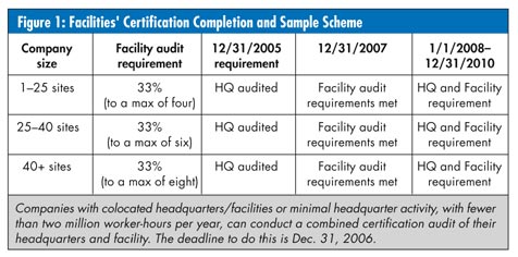

The schedule for certification completion and sample scheme for facilities is provided in figure 1 below.
