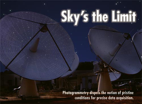

Retroreflective targets appear as pinpoints of light on these 10-meter diameter
Ku-band antennas being measured to determine primary surface adjustments
and evaluate subreflector and feed alignments.

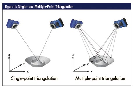

Triangulation is the fundamental principle used in photogrammetry. By taking photographs from at least two different locations, lines of sight can be developed from each camera to points on the object. These lines of sight, sometimes called "rays" due to their optical nature, are mathematically intersected to produce three-dimensional coordinates of the points of interest. Because photogrammetry measures by triangulation, in theory only two photographs are required for a measurement. However, at least four to six photographs are recommended because this range allows the camera to self-calibrate. That is, because the points being measured don't change, as more data are gathered on a point as measured from different angles, more is known about any inaccuracies in the camera itself. These inaccuracies can then be calibrated out of the result.

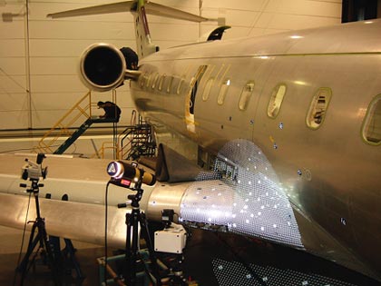

This photogrammetric setup uses retroreflective targets and a
stroboscopic light source to measure a wing section.

The interior or exterior of an aircraft isn't structurally sound enough to support or mount a traditional portable CMM, which requires a stable platform for accurate data capture. Stabilizing a large-volume object such as an aircraft to the extent necessary to obtain accurate measurements could require moving the aircraft indoors, jacking the aircraft and removing all the personnel on the plane. Typically, these options aren't acceptable to the manufacturer. A photogrammetry system is an ideal solution for such a situation.
ATT recently secured a contract to provide metrology services for measuring the large aircraft infrared countermeasures (LAIRCM) system on Boeing's C-17 cargo plane. The project requires measurement of the LAIRCM components using digital photogrammetry to determine their spatial relationship in the aircraft's tail cone section. Measurements are captured outdoors, at night, often in windy conditions in excess of 20 knots and with aircraft movement exceeding ± 2 in. ATT is able to target the aircraft, take digital photographs, process the results in a few hours and achieve accuracies better than a few thousandths of an inch.

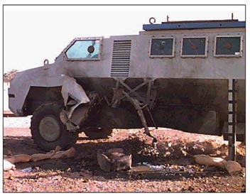

The ADI Bushmaster is an all-terrain multifunction armored vehicle. Built for the Australian army, it's delivered in many configurations, ranging from frontline troo
Bushmaster after mine detonation
p carrier to mobile hospital. The vehicle must remain operational after being subjected to the destructive forces of a land-mine blast. A digital photogrammetric survey was conducted by Vision Metrology Services of Victoria, Australia, to quantify the deformation incurred by such a blast to within 0.30 mm.
An initial pre-blast measurement involved both offline and online photogrammetry methods to establish 3-D coordinates of selected points on the vehicle. A number of these points were assumed stable and would serve as control points to compare data from the pre- and post-blast surveys. A 2.5 sq. m grid with a density of 200 mm was drawn on either side of the Bushmaster's lower hull because this part of the vehicle would experience the brunt of the blast. Center punch marks were placed at each of the 240 grid intersections and subsequently measured in online mode.
The vehicle was transported to a bombing range and prepared for the test. Explosives equivalent to 1.5 standard land mines were placed beneath the hull to simulate a direct hit. The image on page 28 shows the Bushmaster after mine detonation. As expected, a substantial crater was formed in the ground beneath the vehicle, and a considerable amount of designed deformation occurred to the hull. Once safety officers had cleared the site, a second survey was conducted. The center punch marks provided a convenient means of accurately relocating the probe tip at the same surface point. The 3-D coordinates from the pre-blast survey were compared to those from the post-blast survey to determine the magnitude and direction of displacement.
