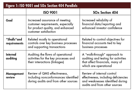

A QMS such as ISO 9001 can provide objective evidence that an organization is operating with the proper controls, policies, procedures and practices. ISO 9001 gives attention to the operational controls--such as booking customer orders, purchasing raw materials, fulfilling orders, and handling customer returns and complaints--that help ensure customer requirements are met. Those same operational controls are the foundation for much of the organization’s financial data (e.g., inventory, revenue, customer credits and/or allowances). Even ISO 9001’s requirements related to job duties, responsibilities and communications throughout the company contribute to the “control environment” that’s so important for the credibility of financial information.

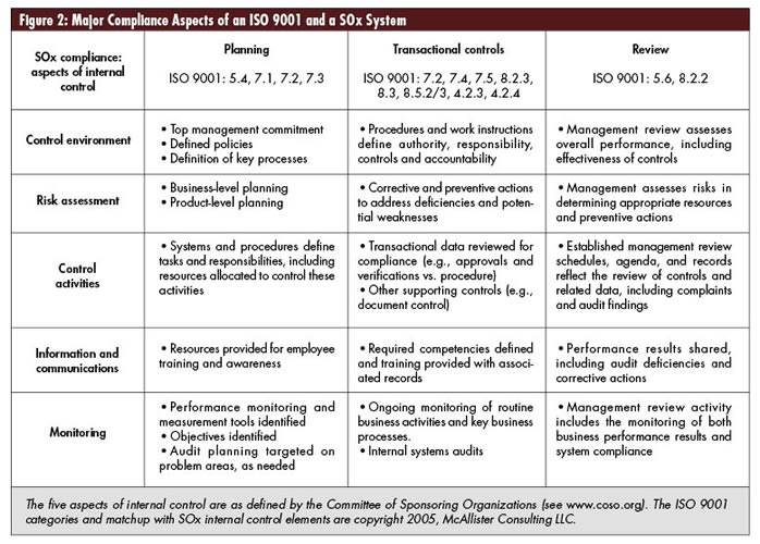

The article “Leveraging Your ISO 9001 System for Sarbanes-Oxley Compliance” (Quality Digest, February 2005) introduced some of the linkages between ISO 9001 controls and the related operational controls that directly affect financial data. The five key aspects of internal control identified by the accounting community--control environment, risk assessment, control activities, information and communications, and monitoring--align with various operational controls in an ISO 9001 system.
This alignment is a good jumping-off place for using your QMS in support of SOx compliance.

ISO 9001 internal auditing is a good way for a company to connect its QMS with SOx Section 404 activities. There are many other places where these two sets of requirements overlap, but we’ll focus on internal auditing.
A practical way to begin is with your existing ISO 9001 internal audit program. Using the similarities and parallels between ISO 9001 and SOx requirements, expand existing ISO 9001 audits to include more auditing of operational controls and their related financial activities. Undoubtedly you’ll need the assistance of your accounting manager, financial internal auditor and others who’ve been involved with financial-based audits. They’ll know the significant financial accounts, related assertions and control objectives that should be audited and tested.
This expanded ISO 9001 or integrated-audit approach to Section 404 compliance can be as expansive or as limited as management’s comfort level dictates. Typically, it involves an ISO 9001 audit of a particular process (e.g., the materials management process) involving related ISO 9001 requirements (e.g., ISO 9001, “Section 7.4--Purchasing”). The accounting profession often uses the “walk-through” approach, which is similar to when an ISO 9001 auditor starts with a customer event (e.g., a quotation), and follows that flow of activity all the way through to product shipping. During an integrated audit, the auditing would continue forward into invoicing and the application of cash received to the open receivable; then backward, examining the controls over customer master setup, commercial terms, credit limits and other, more financially oriented controls. Even if your QMS audits aren’t presently structured in this way, you might want to try this approach. The financial people may also want you to incorporate formal sample-size testing of certain transactions (e.g., samples of customer orders booked, inventory transactions, etc.).
