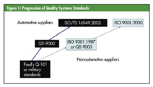

Since the early 1980s, the semiconductor industry has seen a hundredfold improvement in product quality. Organizations such as Motorola epitomized this change. In 1995, when Omnex helped Motorola's AIEG division became QS-9000-registered, Motorola was led by Bob Galvin, a charismatic chairman who was the icon for the resurgence in the U.S. electronic and semiconductor industry. Following that model, most semiconductor organizations followed a quality management systems road map similar to the one shown in figure 1.
In this example, some semiconductor manufacturers, previously following military standards or Ford's Q-101 standard, transitioned to QS-9000 and then to ISO/TS 16949.
This road map resulted in semiconductor organizations sequentially applying gage repeatability and reproducibility; statistical process control; initial sample inspection reports, a predecessor to production part approval process (PPAP); failure modes and effects analysis (FMEA); control plans; 8-D; and others. These systems fueled the quality improvements prevalent in semiconductor organizations. Others (i.e., those that weren't making automotive parts) backtracked into ISO 9001.

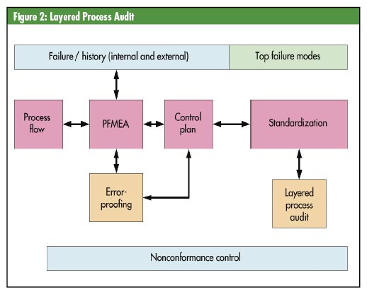

The zero defects movement within the semiconductor industry is being championed by Delphi and Visteon, respectively. These organizations are pushing semiconductor organizations to ship error-free product. The methodology focuses the organization on adopting the following:
Focus on the highest-known risks (i.e., mistakes and errors that have taken place in the last six months, both internally and externally).
Update the FMEA and mistake-/error-proof the failure mode.
Drive this control to the shop floor with effective process control.
Create a layered process audit for manufacturing and support personnel to ensure control is followed, as seen in figure 2.
Zero defects programs are yielding significant improvements within semiconductor organizations.
