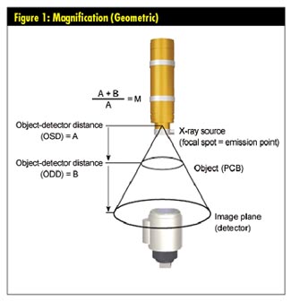

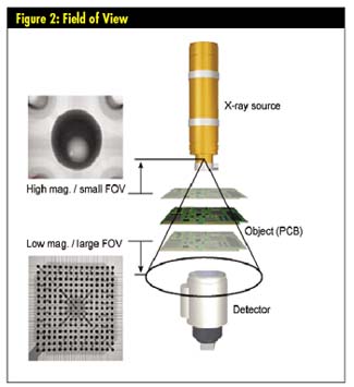

Magnification and field of view (FOV). Magnification and FOV have opposing correlations. Mathematically speaking, magnification is defined as: Magnification (M) equals OSD plus ODD, divided by ODD, as seen in figure 1 below.
The goal should be to obtain a balance between sufficient magnification (i.e., inspection detail) and sufficient FOV. With high magnification, the FOV becomes smaller, thereby reducing the speed at which a board can be completely inspected. Therefore, throughput and magnification are opposing objectives, and the best balance of each depends upon your application. See figure 2 below for an illustration of this principle.
A typical 250 BGA package will require approximately 10X magnification to display full screen, whereas a single ball displayed in full screen will require approximately 350X magnification. Magnification and FOV will vary from machine to machine and are dependent upon how close you can move the sample object to the X-ray emissions point or focal spot relative to the distance to the detector.
