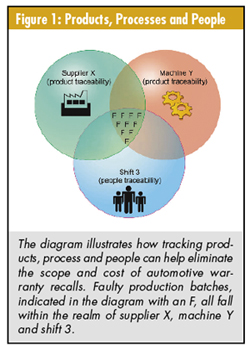

Figure 1 uses a Venn diagram to show incidence reports related to a recall. Note that all of the faulty products can be traced to supplier X (green circle). A track-and-trace system can limit the recall to parts provided by supplier X. Note also that all faulty parts had machine Y in their process plan (brown circle). Thus process traceability would be able to further limit recalls to supplier X parts that were assembled on machine Y. Finally note that all faulty parts were produced during shift 3 (blue circle). In this example, the faulty parts resulted from an individual manually over-torquing a bolt at machine Y on the third shift. A warranty or recall action could be focused specifically to just those parts, saving the manufacturer millions of dollars in recall costs.

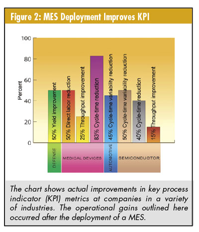

Based on a sense-decide-respond approach, a flexible and configurable track-and-trace solution can achieve a wide range of benefits for automotive and other discrete manufacturers. These benefits fall into a number of categories, including improvements in exception management, overall equipment effectiveness (OEE) and overall factory effectiveness (OFE); quality improvement; user empowerment; lean manufacturing; enterprise performance management (EPM); and supply chain execution (SCE). For exception management, the system senses, in real time, the process, product and people “faults.” This means further processing and/or shipping can be stopped to minimize any corresponding scrap and/or future warranty issues. This early-warning capability can then be linked with other applications to decide how to reconfigure the system to maintain factory goals. With respect to OEE and OFE, the availability of traceability data allows the user to evaluate metrics on a real-time basis and drill down to investigate nonoptimal and suspect operations to determine root cause and decide on the appropriate improvement processes. A track-and-trace solution serves as a key enabler for lean manufacturing by tying components such as productivity monitoring into a factorywide data collection and management infrastructure. EPM is supported by providing a complete data collection and analysis infrastructure across all processes and from low-level sensors up through high-level factory management systems. Finally, the breadth of data collection, storage and management supports SCE initiatives such as warranty cost reduction by reducing the scope of a recall.

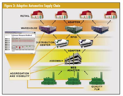

Adaptive Automotive (a fictional company) has multiple suppliers, customers and manufacturing sites for their products. Figure 3 below shows their distribution chain, two manufacturing sites running different manufacturing execution systems (MES) or shop floor systems and a third-party supplier who is also using a different MES system. Prior to implementing their supply chain execution (SCE) solution, they struggled with getting a consolidated view of their entire operations.
Their SCE system has real-time adapters that continuously stream current information from their various enterprise systems and aggregate it into a common data model that's used for compiling real-time reports to a Web-based dashboard.
Adaptive Automotive also uses the dashboard to provide alerts if any of the real-time data indicates an exception has occurred. The company can now recognize problems immediately and has instant access to the most current enterprise information through consolidated reports. This allows for quick analysis and resolution.

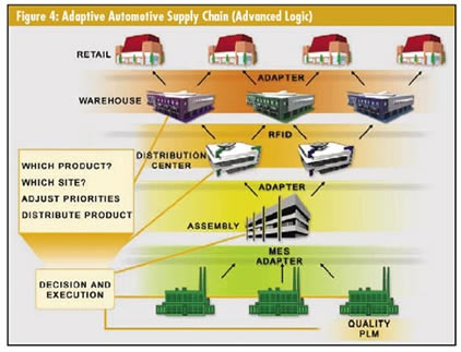

Armed with real-time data from its supply chain, Adaptive can use more advanced logic to make challenging product-routing decisions between sites, as shown in figure 4. For example, if the third-party supplier falls behind on a certain part because of an unexpected machine outage, the system's decision-and-execution capability sees this exception as it occurs and begins to take action. The system can be configured to automatically act on a decision (to prevent any delays from occurring) or to present the options and wait for confirmation before execution. The execution commands are then sent directly to the different manufacturing systems for immediate problem resolution in minutes or even seconds. Now Adaptive is reducing its WIP and, as a result, driving a shorter lead time.
Adaptive is starting to see measurable improvements in its most important key process indicators (KPI). The company's manufacturing and assembly sites adjust priorities and product based on demand-driven changes in the market. Adaptive's real-time manufacturing applications let all its sites seamlessly share tool setup data, tracking data, quality information, order information, lot history, and bills of materials regardless of the shop floor or manufacturing system used at each site. Multiple sites can operate as a single entity, ensuring the optimal use of all resources at the sites. Adaptive's global manufacturing environment is fully collaborative, both internally and with its extended supply chain and customers. The company provides ultimate efficiency and the ability to react in real time to changes in both the supply chain and demand.
