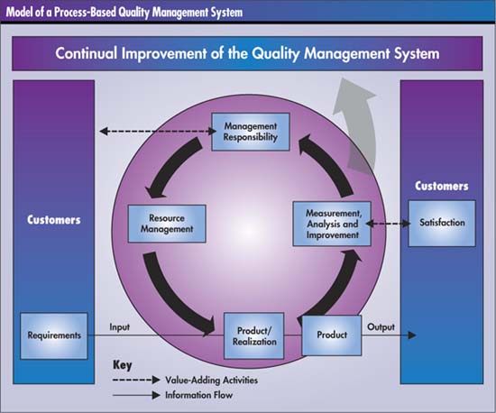

The “Model of a Process-Based QMS” in ISO/TS 16949 makes it clear that continuous improvement requires an ongoing process. Repeating steps one through 10 on a regular basis, perhaps two to four times a year, can become the method for a never-ending cycle of quality and productivity improvement.
