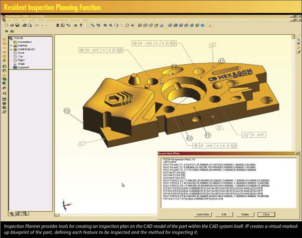

Wilcox Associates, developers of PC-DMIS metrology software, has recently introduced PC-DMIS Inspection Planner, which is comprised of two distinct modules. The first is the IP Planner, an add-on software module to existing CAD systems. The IP Planner allows design engineers to use the CAD system to define an inspection plan, which will contain all the information relevant to inspecting the component. The IP Planner effectively creates a virtual, marked-up blueprint of the part, defining each feature to be inspected and the method for inspecting it. It allows the engineer to define data, dimensions and the necessary metrological relationships among features. All this is accomplished using a set of integrated tools tailored for the specific CAD system. The Inspection Planner module is currently available for SolidWorks and Unigraphics, and several other CAD systems are on the way.

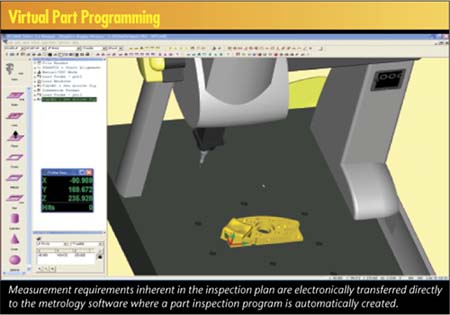

The second piece of the Inspection Planner suite is the IP Measure module. Where the IP Planner module creates the inspection plan, the IP Measure module puts it to maximum use by automatically creating a part inspection program on the targeted metrology device. The measurement requirements inherent in the inspection plan are transferred directly to the measurement software, where a part program is then automatically created, the probing path optimized and the entire routine checked with collision-avoidance algorithms before it’s executed on the physical inspection device. The process is direct and paperless. Because the plan is conveyed electronically, there’s no chance of losing or misconstruing design intent in the process.
For example, CMM operators and programmers can use PC-DMIS software to automatically generate part programs from Inspection Planner files. The time needed to build a part program using this approach is a fraction of what’s required using conventional methods because programmers don’t need to manually input motion or measurement commands or reams of information from paper blueprints into their inspection routines. This approach vastly minimizes the opportunity for introducing programming errors.
PC-DMIS software includes a virtual-part programming environment that doesn’t require the CMM or any other inspection device--or even the part itself. The operator can simulate the entire part programming environment, including the machine, probe, part and fixture setup, using 3-D animation tools.

Many CAD systems now have geometric dimensioning and tolerancing functionality built into the modeling environment, which is another advantage of using the CAD system to create an inspection plan. GD&T is a standardized language of symbols and concepts that allows a designer to describe parts and part features in a precise and logical way. GD&T provides the geometric definition of part and feature size, shape, location and orientation. The shape and tolerance determine the limits of production variability.
There are seven shapes, called geometric elements, used to define a part and its features. There are also certain geometric characteristics that determine the condition of parts and the relationship of features such as straightness, flatness, profile, parallelism, position, total runout and others. These symbols form a common language everyone can understand. With CAD-integrated inspection planning, GD&T symbols can be easily converted into inspection plan commands that form the basis of the subsequent part program.
