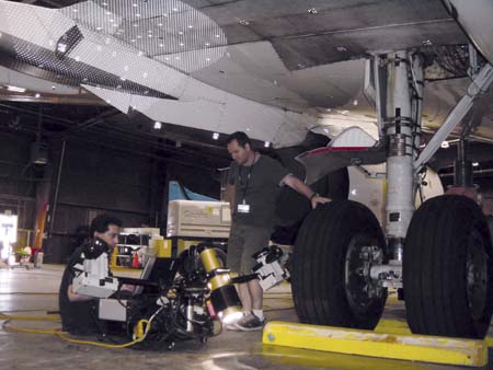

While targeting has long served as photogrammetry’s mainstay, new developments in the technology give quality technicians effective ways to capture points of interest on an object. For example, with a multiple-camera system, hand-held probes can now actually touch these points on the object. These small, lightweight and wireless probes come in several configurations and can use interchangeable CMM tips. When used with probes, a photogrammetry system transforms into a portable, hand-held CMM.
New noncontact measurement techniques using specially developed projectors can project thousands of dots (i.e., targets) on an object’s surface instead of, or in addition to, targets mounted to the object. These devices can measure static objects by taking photos of the projected targets from various locations. In this mode, the projector and the measured object must be stable during the brief period of photography. However, when used with two synchronized cameras and a stroboscopic light source, the system can “freeze” the dots on the object and accurately measure moving objects or objects undergoing deformation. Even parts moving down an assembly line can be measured in this way.
Targets projected along bottom of wing
The high-speed synchronization of cameras and projectors also means they don’t have to be firmly mounted and can be used just about anywhere. A photogrammetry system could be mounted on a cherry picker, for example, and used to measure the top of an airplane.
A projector’s spot brightness depends on several factors, including the measured object’s color, shininess, curvature and distance from the camera. Together these factors determine how large an area can be measured in a single setup. As a rule of thumb, an area about 20 ft in diameter can be measured in a single setup if it’s white, flat in finish and approximately flat in shape. An area about 2 ft in diameter can be measured if the measured object is black, shiny and convex.
Projected targets aren’t directed to a particular location. The projector slide has a nominal grid of targets projected onto the measured object, and they fall where they fall. Thus, it’s suitable for characterizing a surface’s shape but not for measuring particular features such as holes or edges. However, probes or feature targets can quickly and accurately measure such features.

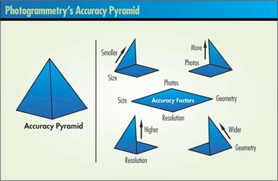

Photogrammetry’s accuracy
Photogrammetry provides accuracies comparable to those achieved by other large-volume, high-accuracy portable coordinate measurement systems. Typical accuracies are 25 to 50 µm (0.001 to 0.002 in.) when completely viewing a 15 ft area (in such a case, the camera would be roughly 15 feet from the object).
However, photogrammetric accuracy depends on several interdependent factors:
Camera resolution
Size of the area being viewed/photographed (corresponds to camera-to-object distance)
Number of photographs taken
Geometric layout of camera stations (i.e., camera locations) relative to the object and each other
Based on these factors, accuracies can vary. Their effects are illustrated in the figure above. To get higher accuracy (i.e., a higher pyramid), you need more of the items shown on the lines of pyramid (e.g., higher resolution, smaller area under view, more photos or wider geometry). As a rule of thumb, if you take six to eight photographs with good geometry, and each photograph captures the entire object, you should obtain accuracies of 25 µm on a 15 ft field of view.
