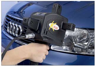

Those days are long gone, thanks to innovations in the mid-1990s that made laser scanning desirable for hand-held applications. The first of these innovations was a new generation of scanners that are much lighter and more reliable than their predecessors. Exploiting the electronics and materials revolutions, scanner manufacturers not only simplified their designs to use fewer parts but also built them from smaller components and lighter materials, such as magnesium.
The availability of reasonably priced computing power played a big role, too. Collecting one to five million points and comparing them to computer-aided design (CAD) files within a minute or two takes a lot of horsepower. Five to eight years ago, that processing speed simply wasn't available. Given the processing power and memory capacity available now at reasonable prices, today's high-end personal computers are more than sufficient for working with the massive point clouds that laser scanners generate.
Perhaps the most overlooked advances in computing technology have been made in the software for operating the equipment and interpreting data. During the mid-1980s, software developers began using object-oriented programming, which organizes code by function rather than sequentially. Object-oriented programs are much shorter and simpler because they refer to the same section of code each time a particular function occurs, instead of repeating the code each time in the sequence. As a result, it's easier and cheaper to develop sophisticated programs that run quickly, contain more features and have simple, intuitive user interfaces.

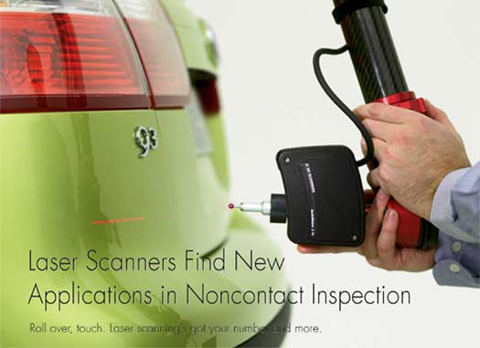

Measurement arms embrace laser scanners
About the time that the new generation of lightweight laser scanners appeared on the scene, manual coordinate measurement arms had just co
me into their own. They could do a job without special programming. The operator simply defined a coordinate system and either touched the appropriate points with a probe at the end of the arm or moved a laser scanner on the arm over the features to be scanned.
The manufacturers of these arms, FARO Technologies Inc. and ROMER Inc., had adopted an open architecture to encourage the development of tools that would expand the range of applications for their products. They viewed laser scanners as one of these tools and were eager to promote them. Largely because of their marketing strategy, laser scanning found its first significant set of successful applications.
Admittedly, most of these applications were restricted to reverse engineering, design and troubleshooting. Equipment portability was a boon for these applications, but its manual nature made it impractical for in-process inspection, which is where most potential applications are found. Establishing laser scanning in the heart of the inspection market would require one or more platforms that could automate the measurements to speed the process and remove human error.

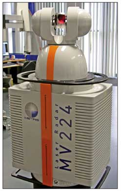

Laser radar is another platform for automating noncontact inspection with laser scanners. Although the technology has been available for a decade, it really hadn't found much practical use until recent advancements made automation more appealing. Because of the automation available now, a number of manufacturers of large assemblies, such as aircraft, have replaced their laser trackers and theodolites with laser radar.
Originally, manufacturers of laser trackers designed the devices f
or laying out large components and putting equipment into position. Over time, they adapted the technology for inspection by developing a hand-held tracking ball. To use it, one operator climbs on or under the aircraft and holds the target on the point to be measured while another operator on the ground makes the measurement. During the process, the operator holding the ball must not interrupt the laser beam hitting the tracker ball. If this happens, he or she must recapture the beam before measurement can continue. Some newer tracker technologies, such as FARO's XtremeADM, have mitigated this problem.
Laser radar works on a different principle. Rather than following a tracker ball, it points its beam directly at the hole, slot, surface or other feature being measured. Consequently, laser radar isn't limited to measuring point by point. It can scan complex surfaces, collecting millions of points and forming point clouds just as a laser scanner on a CMM would do.
Because no one needs to climb on the aircraft to hold the tracking ball in place to attract the laser beam to the points to be measured, laser radar's movement can be automated to run an unattended, preprogrammed inspection routine. Radar technology can bring the benefits of automation to inspecting large parts and assemblies much as CMMs do for smaller ones. Not only does inspection occur much faster, but removing the operator from the measuring process also eliminates the major source of error and variability in trackers.
This technology appeals greatly to manufacturers in the aerospace industry, where it has found a number of applications. Laser radar units are already measuring the large solar sails that unfold once a satellite achieves a geocentric orbit around the Earth. Because these sails are made of a thin metal foil, checking them before deployment is a challenge. The slightest breeze, even one caused by a person moving about the room, can cause the sail to move enough to introduce significant error into the measurements. Laser radar solves this problem by allowing the operator to set up the inspection during the day, leave, and let the inspection proceed overnight.
Besides its affinity for automation, laser radar can easily measure composite materials, which pose refraction problems for most other optical systems. Now that composite materials are figuring more prominently in new designs, such as Lockheed's Joint Strike Fighter and Boeing's 787, aircraft manufacturers and their suppliers have been taking notice of the technology.
Indeed, some are already using it to inspect fuselage subassemblies. Using laser radar for this purpose allowed one aircraft manufacturer to chop two weeks from its inspection cycle.
