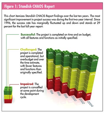

Despite the advance of technology and the implementation of standardized methodologies, the performance of software projects continued to be unacceptable. Most projects failed to one degree or another. Industry's conclusion was that organizations just weren't consistently following the phase-based methodologies closely enough. The third wave commenced in the 1990s and continues today. It focuses on consistently implementing and optimizing an organization's software development methodology. The leading process improvement system is the capability maturity model integration (CMMI), whose ultimate goal is to help organizations maintain continuous improvement in productivity and keep quality under objective control.
After more than 50 years of technological enhancements and a decade of process improvement, one might expect the industry to have a foolproof system in place to produce successful software projects. However, according to the tenth edition of the Standish Group's CHAOS Report, the disturbing fact is that fewer than one in three projects are completed successfully, and only a marginal improvement in the rate of project success has occurred since 1996. (See figure 1 below)

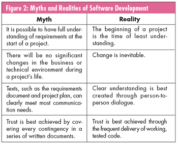

The myth of omniscience assumes that by the end of the requirements phase, the customer has gained and communicated complete knowledge of every single requirement that must be fulfilled by the completed software. It also assumes that developers can translate that knowledge into a design document providing the detailed blueprint to follow throughout the entire project.
Customers don't test software until the final phases. They only realize that they've missed key requirements as they evaluate the software. Any necessary corrections are very expensive at that point in a project. The net result is either software that doesn't fully deliver the business solution that's required, or a project that's plagued by significant time and cost overruns.
The myth of frozen time assumes that no unforeseen changes in the business or technical environment will occur during the life of a project. A Waterfall project uses the same strategy an ostrich does when it puts its head in the ground and pretends nothing scary is happening in the world around it. Unfortunately, constant change is the most predictable aspect of the modern world. Mergers, new business partnerships, technical advances and new regulations can all affect a project. The net result is software that may meet the business requirements that existed at the time a project started but doesn't meet current needs.
The myth of written clarity assumes that the customer and developer can transcribe their omniscient knowledge and oracle-like precognition in complete and unambiguous requirements documents. Traditional methodology includes no systematic means for ongoing communication between the customer and the developers after the initial phases. When communication is required, it's often through one or more intermediaries rather than directly between the people working on the code and those who will utilize the completed software. Like the child's game of telephone, the more people and documents between the programmer and the customer, the more garbled the information will be. The net result is software that delivers what the developer thought the customer wanted but misses the mark on what the customer actually requires.
The myth of contractual security assumes that documenting every aspect of a project ensures that developers will deliver optimal software. The customer keeps track of a project's ongoing performance by evaluating documentation rather than by personally interacting with the evolving software and the development team. The problem with this approach is that a project's real value can only be judged by testing and using the actual software. By the time this is possible in a Waterfall project, it's too late. The results are projects that may have checked off all of the boxes in the requirements document but fall very short on delivering exceptional software.

About the same time organizations started optimizing the phase-based methodology, individual software developers began to experiment with the agile approach to project methodology. Instead of the myths of phase-based methodology, these pioneering coders developed methods that were based on the reality they work in, as seen in figure 2 below.
