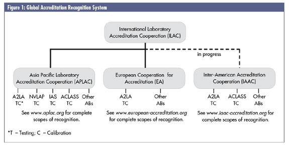

To understand how these MRAs work, and their value, you must first understand the structure of the global accreditation recognition system, as seen in figure 1 below. At the top of the structure is ILAC, which oversees, develops and facilitates accreditation guidelines and MRAs. An accreditation body can either sign on as an MRA signatory directly with ILAC or with one of the regional cooperation bodies described earlier. When an accreditation body signs an MRA with either ILAC or one of the regional cooperatives, it's agreeing to accept the certification of any lab that's been accredited by any of the other ABs that are also MRA signatories. So the certificate of a lab accredited by the China National Accreditation Board for Laboratories, a member of APLAC, would be accepted by FINAS in France (an EA signatory) or by A2LA in the United States, a direct ILAC signatory.
The value for labs is that a lab accredited by, say, IAS, A2LA or NVLAP in the United States would be confident that their certificates would be accepted by an Austrian customer that normally accepts certificates from one of the EA accreditation bodies.
