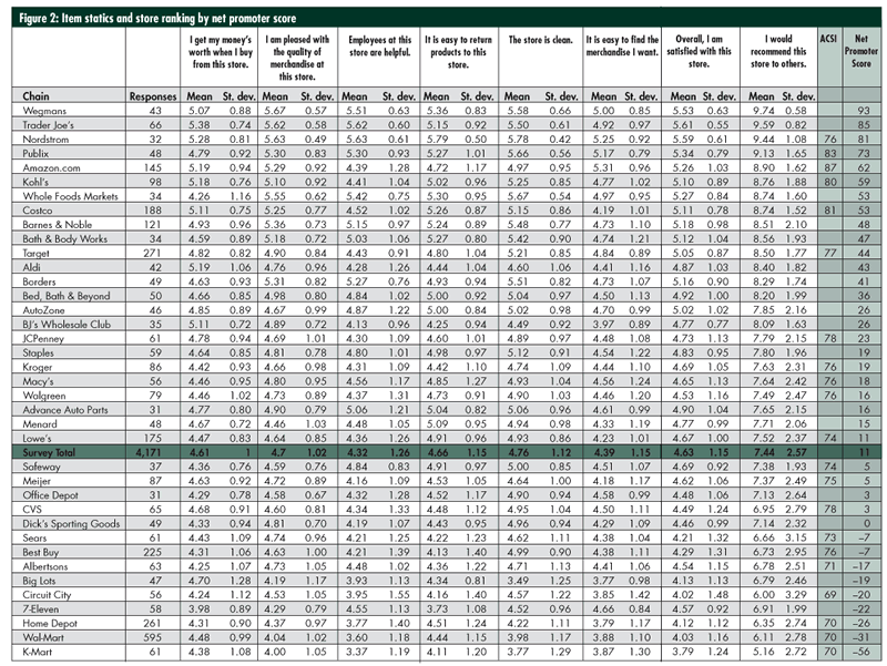

Before the survey, we first asked people what was important to them when choosing a retailer. The key factors turned out to be cost, employee helpfulness, quality of the merchandise sold, return policies, cleanliness and ease of finding merchandise. We converted those responses into survey items, which you can view along the top of the table in figure 2 below. You can also download a pdf of the entire article where the tables will be more legible.
Each item was given a six-point response scale: Completely disagree, strongly disagree, disagree, agree, strongly agree and completely agree. The respondent was also given the choice of "I don't know."

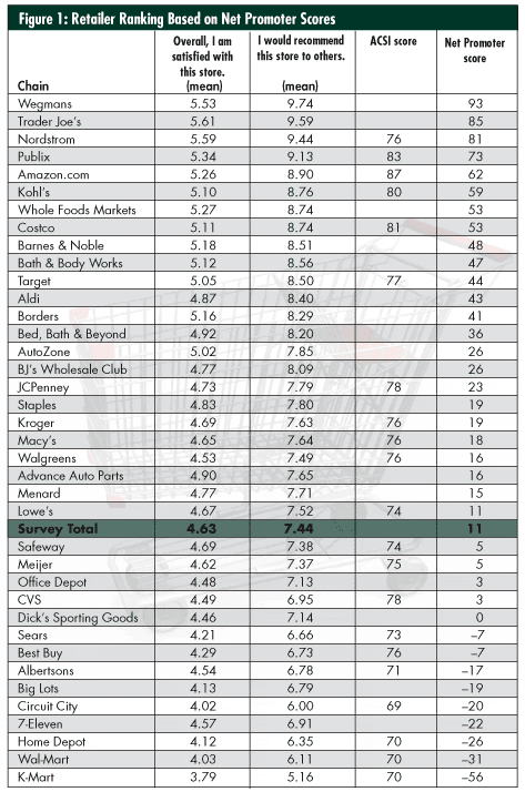

OK. We know you're dying to do it, so before we take a close look at the data, go ahead and look at figure 1 below and locate your favorite stores. We'll wait.
That table contains four columns, each representing a different method of scoring that retailer's customer satisfaction. The first column is the mean of the six-point rating (six is best) for the question "Overall, I am satisfied with this store." The second column is the mean of the 11-point rating for "I would recommend this store to others."
The third column is the score this retailer received from the American Customer Satisfaction Index (if available). The ACSI is an economic indicator based on customer evaluations of the quality of goods and services purchased in the United States. The 12-year-old index was developed by the National Quality Research Center at the Stephen M. Ross Business School at the University of Michigan. For the ACSI, survey respondents are randomly selected via automatic phone dialers, and data collected via one-on-one interviews. For a company to be included in the ACSI, it must have 250 responses. Because the ACSI measures in a scientific way what we are attempting to measure here, we've included the ACSI results when possible as a means to provide some sort of validation for our own results.
The last column in figure 1 is the Net Promoter score for that retailer. The Net Promoter score was co-developed by Fred Reichheld, a well-known loyalty expert, and Laura Brooks, Ph.D., of Satmetrix. The Net Promoter score is based on one "ultimate" question: "How likely are you to recommend this store to friends or colleagues?" In our case, we used the "I would recommend this store to others" item. The question is scored on a 10-point scale, with zero representing least likely. The Net Promoter score is the percentage of respondents giving a score of 9 or 10 (promoters), minus the percentage of those giving a score of 0 to 6 (detractors). The Net Promoter score is purported to be an accurate measurement of customer loyalty. Because the Net Promoter score is the hot new thing in customer loyalty measures, we have opted to use it here.
Though its methodology and questions are quite different from Quality Digest's , there was a reasonable degree of correlation between ACSI's results and ours. With a few exceptions, higher ACSI scores correspond to high Net Promoter scores. The same is true for midrange and low scores.

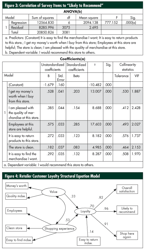

Maybe you don't care about which store placed where. You might, however, be interested in knowing why they placed where they did. What factors have the most influence on customer loyalty? How might this apply to your business? To analyze this, we turned our data over to Tom Pyzdek, an expert in customer survey analysis.
His first pass was a simple regression analysis that looked at the correlation between "Likely to recommend" and each of the six "experience" factors. Looking at the "B" column in the bottom half of figure 3, you can see the correlation values for each of the six factors (bigger is better). Although intuitively you might expect value ("I get my money's worth") to be the most highly correlated with customer loyalty, it isn't. That distinction falls to employee helpfulness, with value close behind. Quality was the third most-correlated factor to loyalty.
This may not be too surprising. Much has been said about product quality being "good enough" and that most people now look at other factors when purchasing products and services. Although some might complain about "cheap Chinese imports" and so forth, what we really seem to care about is how much hassle we're going to get when we try to return those items. As long as service is prompt and friendly, we will deal with higher price or poorer quality. In fact, some survey respondents made exactly that comment. The majority of comments for retailers on both ends of the scale largely focused on service, good or bad.
As we mentioned at the beginning of this article, value may encompass several factors. To look at this, Pyzdek created a structural equation model (SEM) that provides a clear picture of the interaction of all factors and their contribution to customer loyalty. Figure 4 shows a simplified SEM. Two items of note immediately pop out. First, "money's worth" does not stand on its own. It is closely correlated with "quality of merchandise," so that the two items together can be collectively considered a factor that we call "value." The implication is that money's worth is not simply cost but, rather, whether cost is commensurate with quality.
Second, we see a strong correlation between "employee helpfulness," "store cleanliness" and "ease of finding merchandise." We can consider these three items as one factor that we will call "shopping experience."
The "easy-to-return" item is not strongly correlated with any of the other items; it also doesn't contribute much to loyalty, although its effect is statistically significant. We also need to keep in mind that this is a single survey item, while the other factors summarize more than one survey item.
The model clearly illustrates that shopping experience has the biggest effect on loyalty. When this factor changes by 1 standard deviation, loyalty changes by 0.53 standard deviations. When the value factor changes by 1 standard deviation, loyalty changes by 0.33 standard deviations. And when the "easy to return items" score changes by 1 standard deviation, loyalty changes by 0.14 standard deviations. When all of these causes are combined they explain 70 percent of the variance in loyalty.
Tell me what it means
Simply put, our survey seems to indicate that customers value the shopping experience above all else with a key contributor to that being employee helpfulness.
Sure, a decent price and decent quality are important. They're also expected. At this point you and your competitors probably already provide good value, and your customers already assume they're paying what your product is worth. If you're going to keep customers, the key factor seems to be helpfulness (or service). Another indicator of this is Consumer Reports' look at grocery chains. If price were a determining factor in customer satisfaction, then stores like Wal-Mart, which got the magazine's highest mark for price, should be closer to the top of the list.
