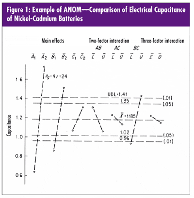

Analysis of means for graphical analysis
Long before Six Sigma's define, measure, analyze, improve and control (DMAIC) methodology, Ott was promoting the use of applied statistics and troubleshooting strategies to characterize and understand a process. His friendship with Shewhart, inventor of the control chart, led Ott to develop a graphical technique that communicated the results of an analysis of variance (ANOVA) from a designed experiment but that could be constructed in the manner of a control chart. This technique was called the analysis of means. In August 1967, he published "Analysis of Means (ANOM)--A Graphical Procedure" in the Walter Shewhart memorial issue of Industrial Quality Control. (The article was reprinted in January 1983, in the Ellis Ott memorial issue of the Journal of Quality Technology). In 1986 ASQC acknowledged Ott with the Brumbaugh Award for this article.
In the article, Ott introduces ANOM by comparing a control chart and ANOVA, which helps put the technique into perspective for the reader:
"The Shewhart control chart is a common introduction to statistical analysis for many engineers, inspectors, chemists and other scientists. When these charts indicate the presence of an assignable cause (of nonrandom variability), an adjustment of the process is made if the remedy is known. When the nature of the assignable cause and the appropriate adjustment of the process are not known, there is a need and an opportunity to design production studies (or experiments). However, the majority of experimenters need professional guidance when they begin to analyze and interpret designed experiments using analysis of variance procedures; consequently, there might be a reluctance to plan and carry out a more sophisticated experimental program.
"The methods of analysis described in this article are an extension of Shewhart control chart techniques. They tend to encourage the design of experiments and are an effective method of presenting the findings. They involve dealing directly with means in contrast to the analysis of variance, in which means are compared by taking ratios of mean squares. The underlying concepts of these two procedures are basically the same; the conclusions are usually the same, but the nature of some differences is indicated in this article." 4
Ott also lists several advantages of a graphical ANOM over the more conventional ANOVA, as follows:
ANOM provides a direct study of possible effects of the factors by working with the means instead of the variances. Thus, ANOM gives a comparison of the relative importance and magnitude of the factors along with their measure of statistical significance.
ANOM provides a graphical comparison of effects. Such a graphical presentation of the results is in a form that's comprehensible to appropriate technical and administrative personnel who aren't trained in statistical methods but who need the information as a basis for decision and action (seen as a critical advantage of ANOM).
ANOM provides a pinpointing of sources of nonrandomness. Whereas ANOVA can identify a factor that significantly affects the response, it doesn't indicate which levels of the significant factor are responsible for its statistical significance unless a multiple comparison method is employed as a supplementary analysis. The amount of effort necessary to complete this degree of analysis has led many to use ANOM as their primary analysis tool.
A graphical presentation of data is a necessity when interpreting the meaning of interactions that are deemed statistically significant by ANOVA.
ANOM is more sensitive in detecting the nonrandomness of a single mean than ANOVA. On the other hand, ANOM is somewhat less sensitive in determining the overall variability of a group of k machines and others like them than ANOVA.
ANOM frequently provides a bonus by suggesting the unsuspected presence of certain types of nonrandom variability; these suggestions can then be included in subsequent experiments for study.
The graphical ANOM has often indicated errors in calculation in an ANOVA. These errors are usually apparent in a graphical presentation even to the untrained eye.
ANOM can be programmed for graphical printout.
