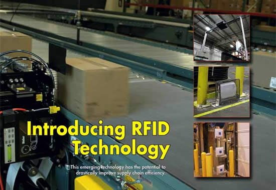

RFID-enabled portals
An RFID-enabled portal is a doorway through which goods travel, and it provides the best opportunities to realize the technology's benefits. There are several different configurations of portals, but the most common is the dock door.
As pallets and cases of RFID-tagged items move through the portal, they may be rapidly identified even when traveling via materials-handling equipment, such as a forklift. Often, it's important to know the direction in which the product is traveling. Directionality can be determined by using one of two methods: calculated or assumed.
Calculated directionality is the most accurate method to determine the path of an item. This works by comparing the outputs of two or more read points. When a tag is seen in read zone A and then in read zone B, it can be determined that the tag is moving from A to B.
Assumed directionality is the simpler of the two methods but not always possible or accurate. For example, if a dock door is dedicated for only outbound shipping functions, it can be assumed that when a tag is seen there, it is traveling out through the door. The problem with this assumption is that goods are often loaded, unloaded and reloaded again. Assuming directionality does not take this process into account.

Conveyance systems
Visibility point . One of the advantages of RFID technology over barcodes is that it does not require a line of sight to scan. If an item traveling on a conveyor is not oriented properly, it can still be read as long as the tag's read zone is designed properly. In some situations, RFID performs so much more rapidly than barcodes that the speed of the conveyor may be increased for faster throughput. RFID equipment is often combined with conveyor diverters to control product flow to the correct destination.
Tag commissioning. If the tag is already applied to an item traveling on a conveyor, an interrogator can encode the tag. This technique is used for some work-in-
progress management applications. The serial number of the item is encoded on the tag at the first stage. As the tagged product goes through the assembly process, its location can be automatically determined. Depending on the RFID technology in use, products on a conveyor may have to come to a complete stop to allow time for the tag to be encoded.
Automatic label applicator/RFID encoder. As with barcode printers, automatic label applicators are also being outfitted with RFID technology to encode tags as the label is applied to a product. It's important to compare the speed of the new RFID encoder/applicator to the label applicator in place. The manufacturing line speed may be increased, depending on the unit being installed. The large image at the beginning of this article shows such a system.
