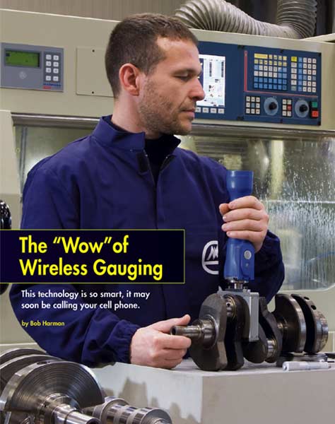

Let’s look at a typical implementation using a simple manual plug or snap gauge and currently available technology, such as the M1 Wave, which is part of Marposs Corp.’s line of M1 Star manual gauges for measuring internal and external characteristics. The gauge itself consists of a Bluetooth-enabled handle that can be mated with a variety of gauging heads to measure inside and outside diameters and thicknesses. The intelligence built into the M1 Wave gauge allows the gauge computer or column to know which gauge head is active, receive the data, and display the result or observe a live reading.
The gauge can communicate with a variety of Bluetooth- enabled data acquisition and analysis devices, including a small, stand-alone gauge computer, or a more capable system with data acquisition and analysis software, advanced data storage and manipulation capabilities.
In this example, the smaller device is a Marposs Merlin compact gauging computer designed to operate in a shop floor environment. The Merlin unit can handle simultaneous inputs from up to 16 conventional devices, or serve as the master for a complete piconet using the Bluetooth technology, depending on application requirements. The gauge computer can also store inspection data or provide outputs in Excel CSV or Q-DAS formats to a memory stick or via LAN Ethernet to a cell or plant server.
The gauge computer has integral communication capabilities featuring Bluetooth technology, and enough processing power to provide the operator with a step-by-step inspection sequence. This is a useful capability for inspecting complex parts with multiple features, such as an automotive transmission case. A stepped inspection sequence ensures consistent results and minimizes the possibility of operator errors.
Connecting a manual plug gauge to a powerful computer with Bluetooth technology may seem like overkill, but the benefits of such a system are real. Implementations like this make it possible to migrate inspection processes upstream from the quality control lab to the machine tool and bring manufacturing one step closer to producing a good part the first time, and every time. Bluetooth technology also means the possibility of your machine tool calling your cell phone to report a problem is one step closer to a functioning reality.
