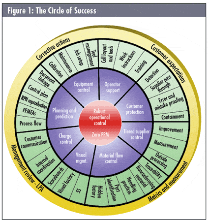

The Circle of Success
Obviously, a lot of work goes into helping suppliers improve, and the majority of the QAAT time is invested in suppliers with problems. However, every company can improve. To make better products, effective suppliers could use cost-effective methods as well. Among the more noteworthy efforts toward this end is DaimlerChrysler’s definition of basic elements needed for success, and making supplier development staff available to any supplier on a project basis.
The thousands of hours spent helping suppliers have revealed patterns and areas of common difficulty. DaimlerChrysler has documented these elements in a straightforward model titled “The Circle of Success.” It’s organized like a target with a central goal of zero customer concerns that’s supported by additional factors radiating out from the center. The initial grouping is the strategic systems divided into eight categories, which are further defined into a set of core processes within each category.
The strategic systems help suppliers focus their energy where DaimlerChrysler has experienced the most frequent problems. Typically, the strategic category often relates to staffs within the supplier organization. For example, customer protection activities most frequently fall into the quality control function, tiered supplier control is usually a purchasing responsibility, and so on. An element in the strategic system layer can often turn into measurable activities that seem to fall closely into business planning efforts.

For the core process layer, Daimler-Chrysler has formulated a set of single-page lessons that can help suppliers understand what’s needed to succeed. These lessons succinctly define the basic expectations for the element and include a graphical representation of the item as well as the details.
As an example, supplier pass-through controls is an activity where the tier-one supplier screens DaimlerChrysler from defects caused by a tier-two source. For instance, if the tier-one supplier is manufacturing the alternator for a car and they buy an attachment bracket from a tier-two supplier, the holes used by the DaimlerChrysler plant can be checked by the tier one for proper location and size. The tier one can easily perform this check by using a fixture that holds the bracket as a locating device. If the bracket won’t fit on the holding device and the tier one can’t install the bracket, DaimlerChrysler is protected from the error made at the tier- two level.
The Circle of Success and the single-
page lessons are available to all DaimlerChrysler suppliers through the company’s Web-based supplier portal, found online at https://portal.covisint.com/portal/public/tp/daimlerchrysler
