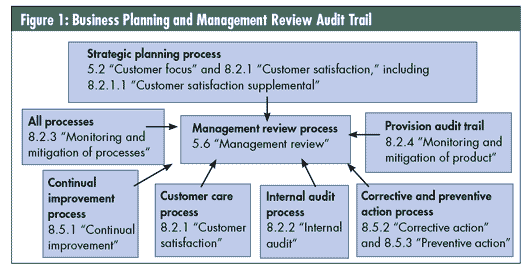

Business planning and management review
Management commitment, along with the business planning process, often guarantees an organization’s success or failure. If the BPM review audit trail is effective, there’s a good chance that the other clauses of ISO/TS 16949 will also be properly implemented in the organization.
In the flowchart in figure 1, “Customer focus” (subclause 5.2) is the starting point.
The phases of the BPM review audit trail, along with relevant clauses from ISO/TS 16949, can be broken down as follows:
The auditor starts the audit with top management, learning its strategic planning process. The auditor samples customer expectations and requirements to evaluate the audit trail.
The auditor uses expectations and requirements to check their alignment with the quality policy (subclause 5.3), and then examines how they relate to the quality objectives chosen (subclause 5.4.1) and the business plan (subclause 5.4.1.1).
The quality objectives drive the quality management system (QMS) planning (subclause 5.4.2), which results in a continual improvement plan and QMS changes.
The plan (subclause 5.4.2) also needs to include new or changed processes under general requirements (subclause 4.1).
The auditor then examines the internal audit process (subclause 8.2.2), the customer satisfaction process (subclause 8.2.1), continual improvement (subclause 8.5.1), and corrective and preventive action processes (subclauses 8.5.2 and 8.5.3).
The results of these processes are examined during management review. If the process-monitoring audit trail and/or operations audit trail are assigned to the auditor, then they should be completed before the management review is audited.
Finally, the management review process is audited to ensure that the QMS is being managed effectively and that performance improvements are taking place. The auditor can compare the organization’s set objectives against its actual performance. The auditor can also gauge if the organization is truly satisfying customer needs and expectations.
For an organization to be considered customer-focused, ISO/TS 16949 requires key customer requirements to have objectives. These must be included in the organization’s business plan and used for policy deployment, and they must have continual improvement goals and appropriate resources. The objectives should also be linked to customer expectations and be achievable in a defined time period.
Therefore, it isn’t enough to sample random customer requirements and objectives. The auditor must start with key customer requirements, follow the trail and then sample related documents. It’s essential that the audit trail is followed thoroughly and completely. The business plan objectives are key pieces of evidence for this audit trail.
The auditor should be able to study a process and ask if the organization measured the right criteria in the process. For manufacturing processes, the auditor must sample specific process information (i.e., process studies and capability).
Samples of five to 10 key customer requirements should be selected to audit this trail appropriately. The auditor should start with customers and end with improvements made to meet the customers’ needs.

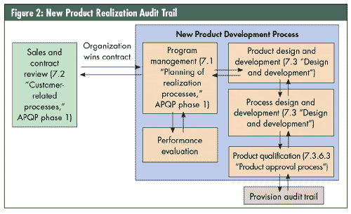

New product development (NPD)
The success of the new product development process is vital to the future of the organization being audited. This process is ineffective in many organizations and often leads to problems with timing, product quality at launch and designs that don’t meet customer expectations.
As seen in the flowchart in figure 2, the audit trail starts by identifying customer-related processes or sales processes (subclause 7.2), then proceeds to program planning, design and development of the product (subclause 7.3), process or technology development and, finally, to the production part approval process (PPAP). In some industries, such as semiconductor design, technology development occurs first. The entire set of advanced product quality planning (APQP) requirements can be audited only when technology and product are being developed initially.
After the PPAP, the audit moves to the operations, process monitoring and improvement audit trails.
The links in this audit trail are those from contract review (subclause 7.2) to the product approval process. To audit this trail, the auditor first selects product samples and tests customer-related processes or sales processes (subclause 7.2) for the contract review. This will verify that the organization has properly identified and reviewed the product requirements prior to agreeing to supply the product. Contract review is a sales and marketing function. To ensure that there’s a trail to product planning and then to the plant, the auditor identifies the products that have recently been through the PPAP or are being produced in the plant.
Next, the auditor examines how the organization has planned the processes required to produce the product identified in product-realization planning (subclause 7.1). This audit of process planning takes place where the organization conducts its project or program management. During this phase, or early in the audit trail, the auditor should document the goals and objectives of the product launch. What were the timing, quality goals and budget at the start of the program? Those in the organization who were involved with program or project management should be able to identify where they started and what the results were. If they can’t, that’s a finding in the audit.
For a product launched a few months to a year before, the organization should provide the auditor with the quality history or scrap, rework and customer rejects data. It’s important that the auditor conducts this performance evaluation and subsequently prioritizes the audit areas. He or she then tracks a sample product through design and development (subclause 7.3) to test that each step of the new product and process development procedure has been followed. Finally, the product approval process is reviewed for content and effectiveness.
It’s always good to sample a variety of products, including those that have been running for one year, those that were recently introduced and those still in the pipeline. The auditor should try to audit each of these and many others chosen randomly when auditing customer-related processes (subclause 7.2). In this way, contracts that were won and lost will be audited. The auditor can study how customer requirements for a particular product were gathered by the organization, as required in subclause 7.2.
The audit scope and product definition are important on this audit trail because a product could include hardware, software, service and processed material. The auditor should carefully define the scope ahead of time.
