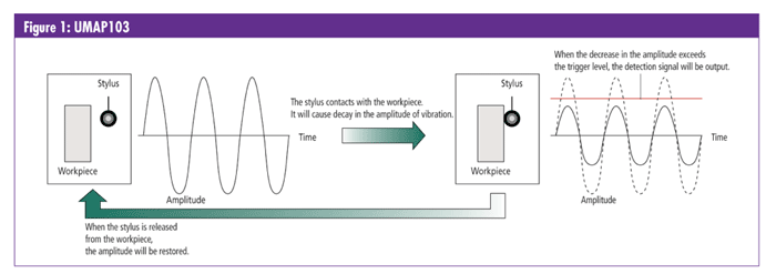

Unlike a traditional touch probe that relies upon deflection to trigger a contact, the UMAP103 depends upon the dampening of an ultrasonic field when the probe comes into contact with an object. As shown in figure 1, the UMAP103 normally vibrates at ultrasonic frequencies at a known amplitude, which is measured by the detecting circuit. As the probe comes into contact with the workpiece, the amplitude of the ultrasonic signal decreases. When the signal drops to a predetermined level, the probe is considered to have touched the workpiece. This means that the contact force is very low, generally around 1 µN.

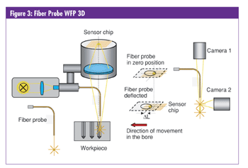

The Werth Fiber Probe WFP 3D has been around for several years but still boasts the smallest probe size--down to 12.5 µm. The spherical glass tip is mounted on the end of a fiber-optic shank that is offered in sizes from 20-200 mm (about 8 in.) long. The length of the shank is limited only by the focal length of the measuring camera.
The probe tip is monitored by a camera. (See figure 3.) The fiber-optic shank and probe tip are aligned near the center axis of the lens. The camera detects the probe tip's deflection as it comes into contact with the work piece, thus indicating a contact. Because of the flexibility and extremely light weight of the probe, the contact force can be as little as 1 µN. Although the fiber-optic shank is relatively flexible, it's rigid enough that the probe always returns to the same at-rest position after it's been deflected.
Because the probe tip must be visible to the camera, illumination is required. The methods of illumination are either a transmitted light mode, where the probe and workpiece are both visible between the light source and the camera, or in a self-illumination mode. In that mode, the fiber-optic shank is illuminated on one end by an LED, and the light is transmitted through the fiber-optic cable to the probe tip.
