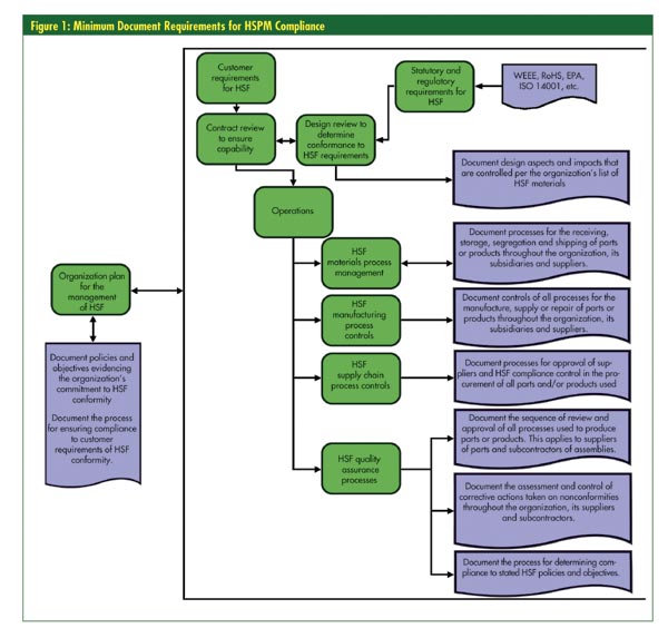

The new IECQ HSPM specification provides a comprehensive, common-sense approach to ensuring that production processes are managed pursuant to achieving hazardous-substance-free operations and finished products. That process management includes elements required for IECQ HSPM compliance, as seen in figure 1.

Customer requirements
As seen in figure 1, the first step in the process is to understand customer requirements. Having records that demonstrate when the review was conducted, who conducted the review, what was reviewed, and any exceptions that exist between the requirements and the company's ability to meet them are essential. Exceptions will also need to be documented and approved as appropriate. This can be done online using electronic signatures if the software application has been validated for this capability.
Design reviews
You must provide access to all regulations, statutes, standards and specifications available to the employees in the organization. This can be done by using the software's documentation-control application. This enables control of electronic documents or an index identifying the location of paper documents as appropriate.
Within the documentation management system there must be a list of all hazardous substances and a plan as to how the company intends to reduce or eliminate them. Documented component specifications are another requirement as well as the specifications for all company-designed parts and/or systems with regards to hazardous substances or hazardous-substance-free parts or assemblies.
Records of design reviews are also required to demonstrate compliance. These records must include who was invited, who attended, what decisions were made and all action items resulting from the meeting.
Your software application should provide at a minimum a database for capturing this information. The corrective action/preventive action (CAPA) database should also have full tracking with alarms and escalation as appropriate. It should prevent the release of a component, product or process until all identified issues are resolved.

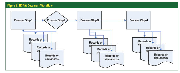

Once the raw material, components and/or assemblies are received, they must be managed in a manner that ensure the integrity of the HS and HSF materials. This includes identification and traceability throughout the organization. Nonconforming material must be identified and segregated. Actions taken to ensure that the material is processed completely are recorded, as is the corrective or preventive action taken to ensure compliance. For each step of the process there must be identified inputs, process activity and outputs. These will then be turned into inputs in the IMS so that appropriate records can be generated to demonstrate compliance.
Process management
