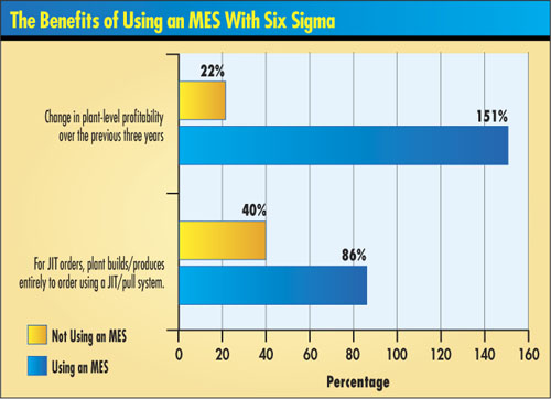

In a database of 106 plants judged to be the highest-performing in North America during a period of five years, 24 responded that they use Six Sigma methods extensively. Within that group, 58 percent of respondents with Six Sigma initiatives also use an MES. Despite the relatively small number of Six Sigma users, the differences within the group are striking. (All percentages listed here are the mean response of the group mentioned--those using Six Sigma and either using or not using an MES.) Here are some results:
Companies using an MES together with Six Sigma improved their profitability 151 percent over three years, whereas those using Six Sigma without an MES improved profitability by 22 percent, as illustrated on this page. Improving profitability by even 20 percent is impressive, but organizations with an MES improved 678 percent more, on average. Some of this profitability came from improved productivity for plants using an MES and some came from cost savings.
Process capability is a cornerstone of Six Sigma strategy. The goal is to create business processes that generate 3.4 defects per million or fewer (Six Sigma including a 1.5 sigma drift). Again, the MES fostered much greater success for the group of companies undertaking Six Sigma in this study. Companies using an MES together with Six Sigma had a process capability (Cpk) of 2.4, compared to 1.5 for those not using an MES to support their Six Sigma initiatives.
Some specific process results were greater cycle-time reductions over three years--more than 54 percent greater in order-to-ship cycle time, the primary target for customer satisfaction. And, among plants using an MES with Six Sigma, the manufacturing cycle time component shrank by more than 82 percent compared to plants using Six Sigma alone (60.6% vs. 33.2% over three years). In a previous study by Industry Directions, “Becoming Demand Driven,” the key indicator of demand-driven performance was revealed to be achieving cycle times shorter than the customer order lead time.
Companies using an MES with Six Sigma also decreased lot sizes more dramatically and were better able to build to order. For just-in-time orders, the plants using an MES built entirely to order 85 percent of the time; those using Six Sigma without the MES data source built-to-order for JIT 40 percent of the time, as illustrated in the chart. Customers who ordered on a JIT basis and got exactly what they wanted built for each specific order were likely to be more satisfied.
