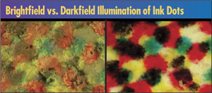

The importance of these advanced contrasting techniques for the compound microscope can be illustrated through the real-life experience of a paper manufacturer. When evaluating the behavior of colored ink dots on the paper, the optical technique of darkfield illumination was clearly required to see how the ink dots behaved on the test paper. Did the ink bleed, run or mix improperly? The darkfield technique enhanced the color contrast by reflecting the light from an oblique angle back through the optical system, as illustrated on page 29. This reflection technique returned each color separated from the rest and provided a more realistic image to the detector--the same as our eyes tell us the color should be. The company previously used a conventional microscope with only brightfield illumination to view the ink. The darkfield-produced image was a dramatic improvement because brightfield illumination transmitted the colors axially, and the resulting color mix produced a lower-contrast image.
