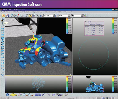

Inspection software
The most significant advancement in CMM functionality has been made to the inspection software. During the last 15 years, online inspection software has evolved from a primitive, text-based programming machine language--limited to driving a CMM to specific locations and collecting results from data points within an X, Y and Z coordinate system--to Windows-based, icon-driven programming fully capable of simulating work cells, reverse engineering, graphical reporting and data analysis. Other major advancements include the ability to program directly from 3-D computer-aided design data, scanning support and laser technology.
In today’s manufacturing environment, the trend is to have 3-D CAD data at the heart of every manufacturing process. CAD systems enable designers to model tooling, fixtures, parts and finished assemblies with complete dimensional specifications in a digital environment. Designers can validate all aspects of the design even before the first parts are made.
Of course, the most accurate results can only be achieved by comparing actual parts to the theoretically perfect CAD model. This is accomplished by using CMM software that can create programming code simply by selecting surfaces and features directly from the CAD model. This code can drive the CMM and probe or scan selected surfaces. The resultant data represent the deviation between the actual part and the theoretically perfect nominal of the CAD model. These results can be formatted and output in a variety of graphical report formats, including HTML. They’re much easier to interpret and enable engineers to see the deviations in the part by means of color maps and vector graphs.

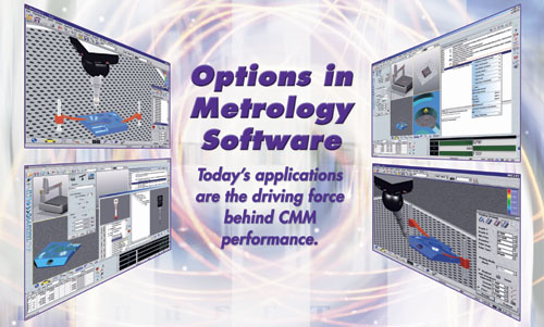

The variety of CMM software available includes online control and offline programming software that can be used to write CMM programs utilizing fully dimensional CAD models. This ability to program existing CMMs using a Windows-based graphical user interface has not only decreased the time it takes to write the programs but also increased the accuracy of the results and cut down on the time needed to analyze the data. Writing programs using a CAD model has enabled third-party software companies to develop offline programming software that’s independent of the CMM and can run either on the CMM’s computer or a stand-alone PC. This allows users to write programs offline instead of disrupting the CMM’s scheduled workflow.
Some offline programming software, such as Silma’s CimStation Inspection, enables the programmer to create complete virtual work cells that include the CMM, probing system, rotary tables, probe changers and CAD models. During simulation, the software can detect collisions and either automatically edit the path to clear them or alert the programmer that a collision would occur if the program were run on a real CMM.
Many CMMs are utilized less than 50 percent of the time to actually check parts. The rest of the time is spent writing and editing programs and setting up the part. By contrast, offline programming can be written as soon as the CAD model is available, which enables the programmer to design the program much earlier in the production timeline.
In Silma’s software, programs are written in native DMIS, fully simulated, tested and generally written in much less time. They are then ready to be run in their native format or posted in many proprietary OEM formats without the need to program in these languages or write several programs for each target machine.
