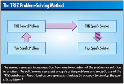

Identifying problem-solution patterns
The practice of TRIZ consists of identifying problem-solving patterns, identifying patterns of technical evolution, identifying methods of using scientific effects, and applying them to a specific situation confronting the developer, as illustrated on page 56.
A powerful demonstration of this method can be found in the pharmaceutical industry. Tailored bacteria are used to cultivate human hormones, producing a superior product to those refined from animal sources. To produce the hormone, though, large quantities of tailored bacteria cells must be cultured, the cells broken open and the cell walls removed. A mechanical method for breaking the cells produced an 80-percent yield, but it was variable at best.3 More recently, the yield had fallen to 65 percent; the pharmaceutical industry wished to increase production to much higher yields.
The problem from a TRIZ standpoint is to find a way to produce the product with no waste, at 100 percent yield and without new complications. TRIZ theory states, “The problem should solve itself.” A generic TRIZ solution, based on patterns of technical evolution, replaces mechanical devices with fields. This may seem very general, but it led pharmaceutical researchers to analyze all the resources available in the problem (e.g., the cells, cell walls, surrounding fluid and its motion, the processing facility, etc.). They concluded that three specific solutions had high potentials for solving the problem:

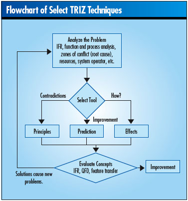

When solving any technical problem, one tool or many can be used. The flowchart below illustrates this.

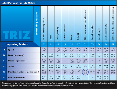

The contradiction matrix
TRIZ research has classified 39 features for technical contradictions. Once a contradiction is expressed in the technical form (i.e., the tradeoff), the next step is to locate specific features in the contradiction matrix.6 The figure on below shows a piece of the matrix.
To use the matrix, find the row that most closely matches the feature or parameter you’re improving in your tradeoff and then the column that most closely matches the feature or parameter that degrades it. The cell at the intersection of that row and column will have several numbers. These identify specific principles of invention that are most likely to solve the problem, that is, to lead to a breakthrough solution instead of a tradeoff.
For example, consider the proposal to change airbag inflation speed to reduce injuries to small occupants. The tradeoff is that injuries in high-speed accidents increase. Translating this into TRIZ matrix terms, the parameter that improves is “duration of action of a moving object” (row 15) and the parameter that worsens is “object-generated harmful factors” (column 31). The circle in the figure highlights the cell at the intersection and includes the numbers 21, 39, 16 and 22. These are identifiers for four principles of invention.
Usually the principles are accompanied by examples from a variety of industries. The design or problem-solving team uses the text, those examples and examples from its own previous applications to develop a solution.
Consider the application of principle 21 to the airbag example:
Principle 21: Skipping. Conduct a process or certain stages of it (e.g., destructible, harmful or hazardous operations) at high speed. For example:
  • Use a high-speed dentist’s drill to avoid heating tissue.
  • Cut plastic faster than heat can propagate in the material to avoid deforming the shape.
One solution to the airbag problem, then, would be to inflate the bag faster than current practice, so that it’s fully inflated when it impacts a small person. The “depowered” air bag has been proposed as a solution of this type. By using less power, the bag’s acceleration is less and injuries will be reduced. Conversely, smaller bags with higher power would reach full inflation sooner so that passengers would be protected from accidents and not injured by the bag.
