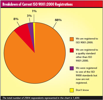

The survey shows that 87 percent of all U.S. and Canadian companies registered to an ISO 9000 or related standard are now registered to ISO 9001:2000, with another 8 percent now being registered to a different standard. So, roughly 95 percent of all companies contacted are registered to some quality management system standard. In our last survey, conducted in July 2003 and presented in the August issue, this group comprised about 56 percent. That means the remaining 39 percent of registrations, between 20,000 and 25,000 certificates, were completed within the last six months. It’s no wonder that the registrars we tried to contact for this story were either unavailable or downright grumpy--the volume of work was pushing the registrars and their auditors to the limits.

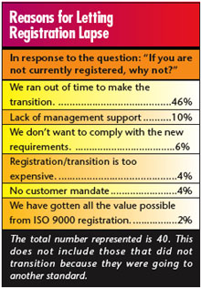

It’s no surprise that the primary reason given for missing the deadline is that the companies simply ran out of time. Of those companies that lost their registration (which excludes companies that are going to another standard, such as ISO/TS 16949), 47 percent reported that they ran out of time. Other reasons were spread fairly evenly: too expensive, no perceived value, plant closures, no customer mandate and so forth.

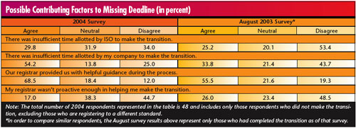

Interestingly, although lack of time was the key issue, most respondents blame their companies and not the International Organization for Standardization’s deadline for missing the transition date. Responding to the statement, “There was insufficient time allotted by ISO to make the transition,” responses were evenly distributed among disagreeing (34%), agreeing (30%) and neutral (31%). On the other hand, in response to the statement, “There was insufficient time allotted by my company to make the transition,” the majority of respondents (54%) agreed, and just one-fourth (25%) disagreed.
Companies didn’t seem to blame their registrars for missing the boat either. Nearly 45 percent of those that missed transition felt their registrars had been proactive in helping them make the transition. Only 17 percent felt their registrars weren’t proactive enough, and 38 percent were neutral.

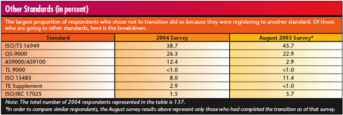

By far, the most prevalent standards to which companies were registered other than ISO 9001:2000 were ISO/TS 16949 and QS-9000. Of those companies registering to another standard, 39 percent reported they’re registering to ISO/TS 16949 and 26 percent with QS-9000.

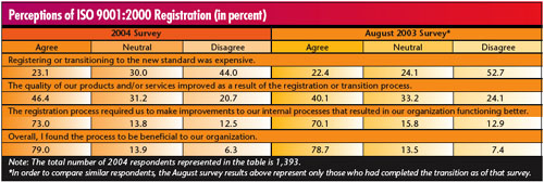

As with last August’s survey, the overall value of ISO 9001:2000 registration is perceived to be very high, with 79 percent of respondents agreeing with the statement, “Overall, I found the process to be beneficial to our organization.” This is the same percentage we got last year for the same question.
Registration’s effect on products and services or on a company’s internal processes was also favorable and similar to last August’s survey. In this survey, 46 percent of respondents agreed that products or services had improved as a result of registration, and 21 percent disagreed. More than 73 percent agreed that their organizations function better as a result of registration; 12 percent disagreed.
Given the fact that registrars had been slammed with a tremendous amount of work to get every organization registered before the deadline, we were somewhat surprised that the registrars got a high score for helpfulness, only a bit lower than the last survey. In response to the statement, “Our registrar provided us with helpful guidance during the registration process,” 68 percent of respondents agreed with the statement compared to 71 percent in August. We would have expected customer service to fall off considerably during this hectic period, but it only showed a slight decrease.
