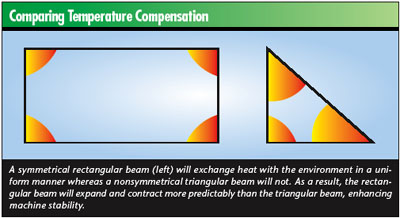

Achieving optimum stability in a structure such as a CMM requires a detailed analysis of every component in the structure. Even the shape of a beam can make a significant difference in its thermal and dimensional performance.
For example, corners tend to be thermal stress points because they heat and cool more quickly than flat surfaces. As a result, rectangular structures tend to be more stable than triangular structures because the corner-induced stresses are symmetrical.
However, triangular structures are both lighter and less expensive than rectangular structures of the same capacity because they contain less material. They’re also easier to fit with preloaded air bearings, as illustrated on page 41.
A cost-driven design will choose triangular beams, whereas performance-driven design will choose the more costly rectangular beams. Over the long run, however, the more expensive design will prove to be the more cost-effective because it’s substantially more stable, and that means it requires fewer recalibrations and delivers more usable uptime. In the end, stability translates directly into reduced measurement costs for the end-user.

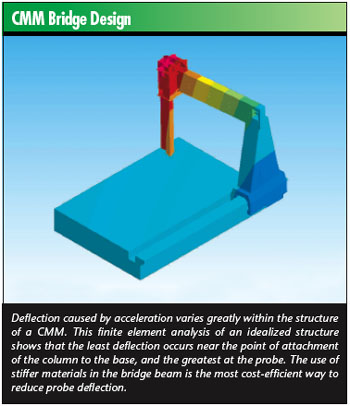

Stiffness is the second major goal in CMM design, and stiffness without mass is the essential characteristic of CMM-style unobtanium. Materials with high stiffness-to-weight ratios tend to minimize many of the mechanical errors inherent in CMM design. Stiff, light real-world materials reduce the mass of moving elements, permitting smaller drives, less heat, shorter measuring cycles and lower costs.
The greater stiffness of ceramic beams shows up in analyses of bridge behavior under acceleration. When accelerated, the bridge beam is subjected to a directional deformation force directly proportional to the acceleration. For an aluminum beam, the resulting directional deformation is nearly twice that of an equivalent ceramic beam, despite the fact that the ceramic component is 32 percent heavier.
In practical terms, this means the ceramic beam can be accelerated nearly twice as fast as the aluminum beam while maintaining deformation within a comparable range. Greater acceleration translates directly into shorter traverse time and reduced cycle time for any given movement and ultimately into a lower total cost for any given inspection task.
Another material with greater stiffness than aluminum--200 percent, to be exact--is steel, which is used increasingly in structural components such as support legs on advanced CMMs. Because of its high strength, steel--like ceramic materials--offers an opportunity to design structures with enhanced performance and only a small weight penalty compared to aluminum. And, like ceramics, steel’s greater stiffness permits higher acceleration and reduced cycle times and inspection costs.

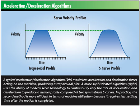

Although software-based compensation systems are rapidly nearing the point of diminishing returns, the same cannot be said for software-based motion control efforts. Today, most CMMs use a simple acceleration/deceleration algorithm that produces a trapezoidal plot. The strategy is to accelerate to maximum velocity as quickly as possible, maintain that velocity as long as possible, and then decelerate to zero as quickly as possible, as illustrated below.
At first glance, this strategy might appear to deliver optimum cycle times. After all, going as fast as possible should be the key to getting from point A to point B in the minimum amount of time; in a large, robust structure, it may well be.
But CMMs are not large, beefy structures. For a CMM, this strategy produces a substantial wait at the end of the motion while the machine “settles down” and dissipates the stresses and vibration generated by the acceleration/deceleration process.
A better strategy is to control the motion to produce a pair of gentle “S curves” during acceleration and deceleration. In practice, this approach may add a fraction of a second to the traverse time from point A to point B, but this will be more than compensated for by the reduction of waiting time once point B is reached.
In an intermittently used laboratory machine, the difference may be negligible. But, in a production-monitoring application, which fully utilizes the CMM’s capabilities, the difference in cost-per-measurement can be substantial enough to pay for the more sophisticated capabilities in a short time.
