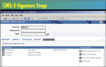

For FDA-regulated companies, compliance to the FDA’s cGMP drives overall manufacturing requirements, just as compliance with 21 CFR Part 11 drives electronic records requirements. These include using validated computerized systems; retaining secure electronic records; system and data security; system access control; using secure electronic signatures; and user-independent, computer-generated, time-stamped audit trails.

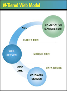

Assessing new architecture technologies
CMS vendors are quick to take advantage of new technology to produce state-of-the-art systems. Such software packages provide not only best-in-class feature sets but also the ability to share data in seconds with hundreds of users from multiple locations.
The technology best equipped to satisfy these requirements is an n-tiered Web model designed to distribute the necessary user interaction, computation and storage tasks between the layers of the architecture. Although some latitude exists in the exact number and structure of layers, a CMS is typically broken up into a client tier, a middle tier and a data store--which is further segmented into a data abstraction layer and a database server.
Client tier. This layer is responsible for interactions with the user. In the past, all application users saw the same interface. Today’s users access their data from a variety of devices with various screen sizes and input methods. The client tier must accommodate the user regardless of the device bridging the user to the system.
Middle tier. Also known as the business logic layer, the middle tier is where data are interpreted and business rules applied. Certain types of security and access checks are also performed at this level. The middle tier is considered the brain of the n-tiered system; a Web server offers the best performance.
Data store. This tier includes the task of data storage and retrieval. Once the choice of a database server is made, a data abstraction layer is created to provide the interface between the middle tier and the database itself. Some popular databases include Microsoft SQL Server and Oracle. For its reliability, MSDE is now frequently used instead of Microsoft Access.
By using a Web-based, n-tiered architecture, CMS software greatly reduces network traffic and the burden on client resources while maintaining security and data integrity. Users aren’t directly bound to the data store, as they are with a traditional client-server application. Instead, the middle tier uses connection pooling to enhance both network and software resources. The result is improved performance.
In traditional Microsoft Access database applications, the system slows down as more users log onto the software. Data corruption is typical. With this modern architecture, a CMS can handle hundreds of users without affecting performance. Moreover, as an organization grows, so must its CMS. Application scalability is very important; among other things, it means tremendous cost savings when multiple sites are rolled into one system.

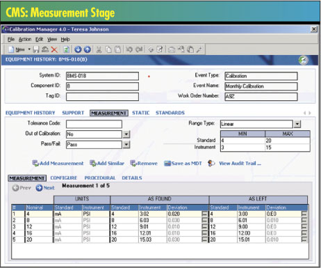

Collecting field data
Collecting and managing both manufacturing and laboratory data is an integral part of today’s calibration process. A CMS must provide the capabilities to easily record such data.
One of the best ways to collect field data is on a notebook PC. Calibration technicians can transfer subsets of instrument records from the main CMS into the notebook-based CMS module. Calibration activities and events are then recorded in the field on the notebook, and the data are transferred to the main CMS. This process eliminates redundant data entry and paper, greatly reducing the risk of error. A notebook PC is ideal because it’s an easy-to-use format, powerful enough to include standard operating procedures as well as captured measurement data.
As the cost of notebook computers decreases and the advantages of eliminating pen and paper are realized, a technologically driven CMS that can provide security features and user options along with a data-collection utility becomes increasingly attractive. For paperless calibrations in regulated industries, robust electronic signatures are also required at the point of data collection.

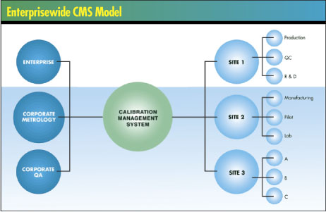

Centralizing calibration across the enterprise
Enterprisewide systems make the best use of new CMS technology. For example, an enterprisewide CMS enables an organization to host the application at a central location while allowing worldwide access to separate departments and facilities. In a typical installation, the database application is hosted on centralized IT servers, configured and controlled by a corporate quality or metrology group, and used by working groups throughout the global enterprise. The software enables each working group to maintain its own dataset configured to its specific needs--including its own field labels, languages or time zones--while centralizing the overall implementation configuration.
An enterprisewide CMS can reduce calibration procedure writing and management, standardize calibration measurement data collection and retention, and allow for instant communication of management and productivity metrics. This system also functions as a platform for collaborative problem solving, which is especially important in cases where employee input is dispersed throughout the enterprise.
Companies that must follow standards or regulations will quickly realize the advantages of an enterprisewide CMS. All FDA-compliant companies must validate the software they use when making products for public consumption. Validation is an expensive and time-consuming task, but with an enterprisewide implementation, it would be required only at the central host site. If a CMS had been installed at each individual site, then a validation would be necessary for each implementation. An enterprisewide CMS can reduce validation costs by up to 90 percent.
It can also add to the bottom line. Through cost reductions in application licensing costs, corporate IT resources, internal auditing and training, the enterprisewide CMS provides the lowest total cost for corporate calibration compliance.
