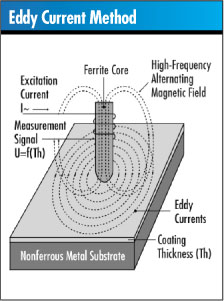

Eddy current method
This method measures nonconductive coatings on nonferrous conductive substrates, nonferrous conductive coatings on nonconductive substrates and some nonferrous metal coatings on nonferrous metals. Eddy current measuring is similar to the magnetic inductive method previously mentioned. It even uses many of the same probe designs.
As with a magnetic induction probe, the eddy current method also contains a coil. In this case the coil has the dual function of excitation and measurement. This probe coil is driven by a high-frequency oscillator to generate an alternating high-frequency field. When near a metallic conductor, eddy currents are generated in the conductive material. This causes an impedance change in the probe coil. The distance between the probe coil and the conductive substrate material determines the amount of impedance change, which can be measured, correlated to a coating thickness and displayed in the form of a digital reading. Common applications include liquid or powder coating over aluminum and nonmagnetic stainless steel, and anodize over aluminum.
As with the magnetic inductive method, the eddy current method’s reliability depends on the part’s geometry as well as the coating’s thickness. Users should know the base substrate prior to taking a reading. An eddy current probe shouldn’t be used for measuring a nonmagnetic coating over a magnetic substrate such as steel. Neither is this method reliable for measurements of nickel over aluminum.
In cases where users must measure coatings over magnetic or nonferrous conductive substrates--such as in a job shop--they’d be best served with a dual magnetic induction/eddy current gage that automatically recognizes the substrate.

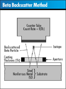

Beta backscatter method
This method begins when a test sample is exposed to beta particles from a beta-emitting isotope. A beam of beta particles is directed through an aperture onto the coated component, and a proportion of these particles are “backscattered” from the coating through the aperture to penetrate the very thin window of a Geiger Muller tube. The gas of the GM tube ionizes, causing a momentary discharge across the GM tube electrodes. The discharge--in the form of a pulse--is counted and then translated into coating thickness.
Materials with low atomic numbers backscatter the beta particles at a significantly lower rate than materials with high atomic numbers. For a sample with copper as a substrate and a gold coating of 40 µm, beta particles are scattered by both the substrate and the coating material. If the gold coating thickness increases, so does the backscatter rate. The change in the rate of particles scattered is therefore a measure of the coating thickness. Reliable applications for the beta backscatter method are measurements where the atomic number of the coating and substrate differ by 20 percent. These include gold, silver or tin on electronic components as well as coatings on machine tools, decorative plating on plumbing fixtures, and vapor-deposited coatings on electronic components, ceramics and glass. Other applications could include organic coatings such as oil or lubricant over metals.
The beta backscatter method is useful for thicker coatings and for coating/substrate combinations where magnetic induction or eddy current methods won’t work. It’s also less costly than the X-ray fluorescence method.
Changes in alloys affect the beta backscatter method, and different isotopes and multiple calibrations might be required to compensate. An example would be tin/lead over copper, or tin over phosphorous/bronze. Both applications are typical in printed circuit boards or contact pins, and in these cases the changes in alloys would be better measured with the X-ray fluorescence method.
