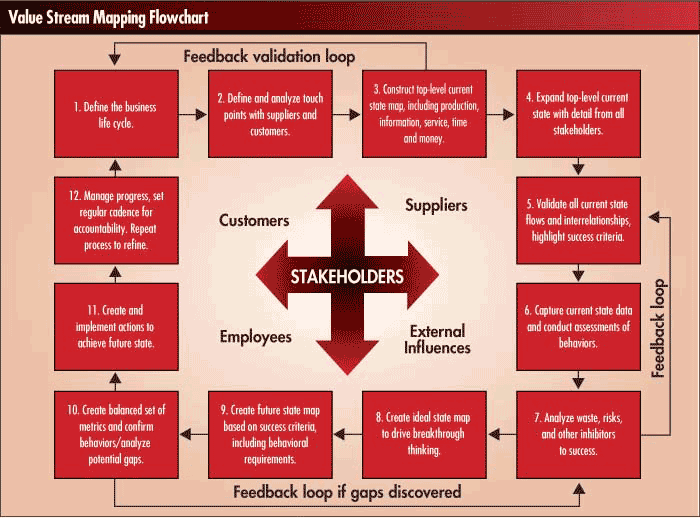

Absolutely. The value stream mapping flowchart on page 35 illustrates a methodology that will lead to a clear map of processes feeding into and through a company before being realized by the customer--i.e., the total supply chain.
Each of the 12 steps follows the lean value-stream mapping methods from James P. Womack and Daniel T. Jones’ invaluable Lean Thinking (Free Press, 2003). These steps involve every function at every level of a company, whether large or small, manufacturing or service. Additionally, when companies recognize that variation is undesirable in the quality world, they can incorporate Six Sigma variation-reduction methods to strengthen the streamlined processes and devise the balanced metrics needed to measure success.
The 12 steps for conducting total supply chain value-stream mapping and analysis are as follows:

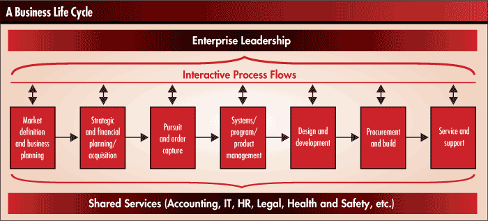

For example, a generic business life cycle for a company might look like the figure below.
