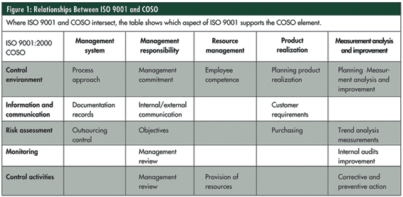

ISO 9001, itself an internal control system, is well-suited to address the COSO elements. In fact, your existing ISO 9001 QMS can easily be expanded to provide the type of documentation and oversight required by COSO, or provide a stable platform of processes and procedures outlining how COSO elements should be addressed. Keep in mind that SOX does not have a particular document structure in mind to use as proof of compliance. COSO is simply a recommended structure that works, and its elements are easily covered by your existing QMS. However, there are some key parts of the COSO guidance that are not covered by an ISO 9001 system. Examples are fraud detection and prevention, management of financial control and reporting processes, controls to prevent material misstatements in the company's financial reports, and processes to ensure segregation of duties. In a sense, linking COSO and an ISO 9001 QMS goes a long way to solving the issue of structuring the COSO internal control system, but there are specific COSO activities that must be added.
The COSO control environment element is the foundation for all other COSO elements and provides discipline and structure in the organization. Likewise, ISO 9001 contains requirements for the process approach, multiple planning activities, developing a quality policy, measurable objectives, internal communication, and employee competence. The ISO 9001 requirements provide a basic structure of a management system that can serve as a foundation for the COSO guidance.
The COSO information and communication element requires that pertinent information be identified, captured, and communicated in a form and time frame that enables people to carry out their responsibilities.
ISO 9001 supports the information and communication clauses by controlling documents and records. These clauses stabilize the procedures for handling information that will be used in the COSO internal control system. ISO 9001 also defines communication requirements for all three stakeholders: the organization, its customers, and its suppliers.
The COSO risk-assessment element requires the identification and analysis of relevant risks to achieving objectives, and the basis for determining how the risks should be managed.
ISO 9001 supports risk assessment by developing measurable objectives. Next, there's the review of customer requirements, which often identifies high-risk elements that can affect an organization's ability to serve its customers. ISO 9001 also requires the organization to monitor and measure its products and processes and provide these data for analysis. Other inputs are customer satisfaction and supplier data. A key part of the analysis is identifying trends used to specify opportunities for corrective and preventive action, and that serve as inputs to management review. Applied to COSO, your ISO 9001-based systems can be used to document financial objectives as they relate to stakeholders.
The COSO monitoring element requires a process that assesses the quality of the system's performance over time. A key tool used by organizations to do this is internal auditing.
ISO 9001's support of monitoring is closely related to its support of COSO's risk-assessment element. It includes defining measurable objectives, monitoring and measuring products, data analysis, and internal auditing. Just as it can include processes and procedures for monitoring a manufacturing process, an ISO 9001 QMS can include the necessary information for monitoring a company's financial processes. This information can in turn be used to support COSO requirements.
The COSO control activities element consists of policies and procedures that help ensure that management directives are carried out. Control activities help ensure that necessary actions are taken to address risks to the organization's objectives.
ISO 9001's support of COSO's control activities centers on the management review process. There are requirements for documented procedures to control nonconforming product as well as corrective and preventive action processes. Expanding the role of ISO 9001 management review will greatly strengthen the ability to carry out management directives related to company financial information.
