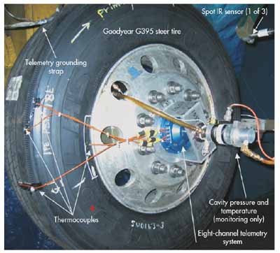

Test setup for monitoriing tire temperature at key points

The basic objective was to build a regression model for these data that would explain the effect of tire operating conditions on internal tire temperatures. "In this particular case, we were most interested in the temperatures on the edges of the belt at the shoulder of the tire, and at the center-line of the tire," says Spadone.
"We wanted to build a regression model that, based on our test conditions, predicts the temperature in the tire. We were successful in doing that," he continues. "We're now able to accurately predict belt-edge and center-line temperatures in commercial, over-the-road truck tires."

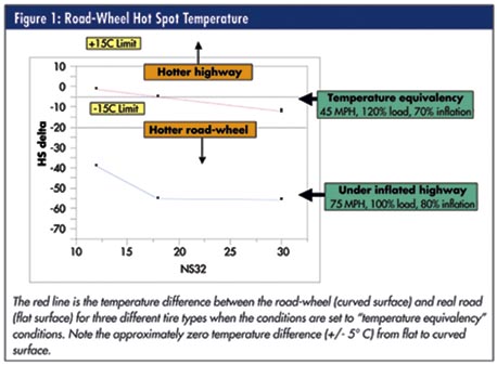

For example, the template allowed them to discover flat and curved conditions that resulted in equal temperatures at the belt-edge and center-line simultaneously for the highway and the road-wheel.
"We were looking for equivalent temperatures 'flat-to-curved,'" says Spadone. "We wanted to demonstrate that 'highway equivalent' operating conditions are required for laboratory testing to avoid tire temperatures significantly hotter than those from 'the road.' We were able to explain that using these templates." (See figure 1 below.)
Not only do the models make this clear to engineers but, more important, to administrators and managers who aren't engineers or scientists. "We could present these models in real time on the screen to show them what was going on," says Spadone. "For example, they might ask, 'What if we ran a truck tire on the road-wheel at 80-percent inflation, 90-percent load, and 75 miles per hour? What would I have to do in the real world, on a flat surface, to equal that center-line temperature?' And the answer would be that you'd have to run at 90-percent load, 80-percent inflation, and 120 miles per hour to approach the same drive tire temperatures."

Spadone and the task group used the software's prediction-profiler function to change conditions and predict temperatures. "Once you have the model built, you can dynamically change conditions and find the answers. This is a really powerful tool for communicating the model. Many times, the answers people got were not the ones they expected. In some cases, they were quite taken aback," explains Spadone.
