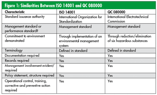

In making your decision, it’s helpful to understand where they intersect and diverge. To the uninitiated, they appear to very similar, as seen in figure 1 below.

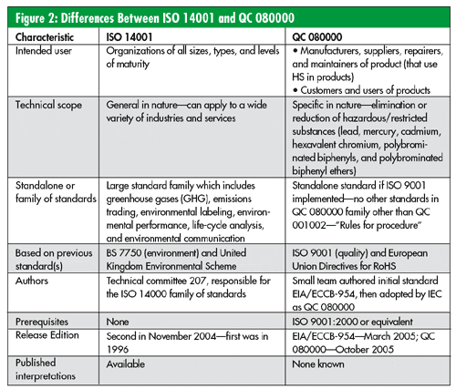

Can your organization pick either ISO 14001 or QC 080000, because they appear to have parallel requirements? Or are the differences more pronounced than the similarities? See figure 2 below for a closer look at these differences.
QC 080000 is promulgated by the International Electrotechnical Commission to govern RoHS by building on the ISO 9001 quality management system (QMS) standard. QC 080000 is essentially a “bolt-on” supplement to ISO 9001; the former’s scope statement even declares, “The requirements of this specification are in addition to those contained within ISO 9001.”
