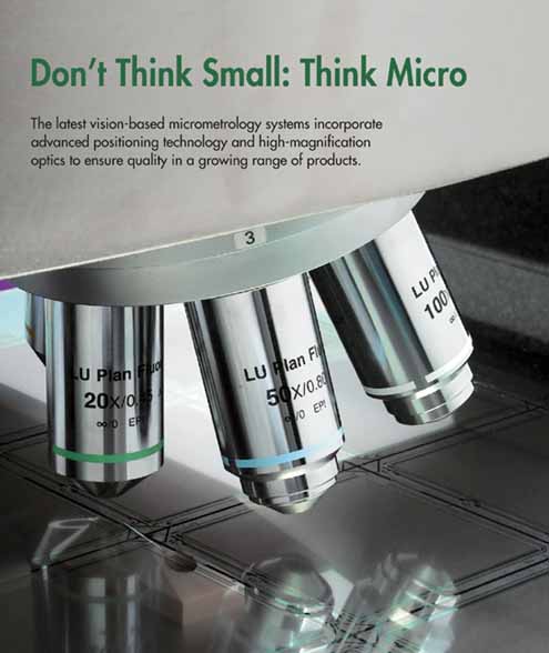

Although FOV and PTP are different, their video-based micrometrology systems typically include similar components, such as turrets, objectives, and cameras. A turret of microscope objectives can move from a low magnification, for locating a feature, to a high magnification, for the actual measurement. Both FOV and PTP systems require metrology software to perform image analysis to determine points or feature locations with the necessary precision, as well as to control system operation in the case of motorized stages and focus mechanisms. Obviously, with PTP measurements, precision depends mostly on positioning accuracy, and stage accuracy is critical.
