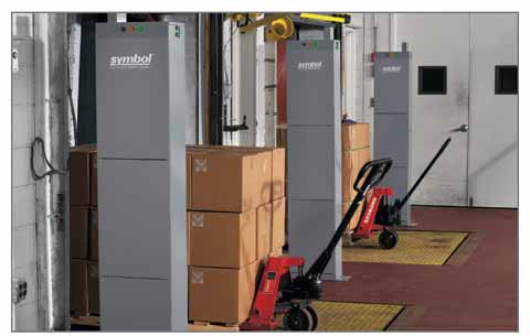

An RFID assembly might consist of two light-metal framework panels in opposing positions on each side of a waist-high conveyor located at the rollup door of an indoor unloading dock. Antennas, in their housings, would be mounted on the framework above the conveyor and opposite each other at a height best suited to the application. Readers would also be mounted on the framework, and the antennas attached to the readers. Optional hardware could include an RFID printer encoder for generating tags.
As incoming items are offloaded from the transport and sent down the conveyor to pass between the antennas, the reader begins transmitting an encoded RF signal via the antennas. The tag antennas sense the signal and pass it on to the chip, which generates a responding signal back through the tag antenna. This signal is then sensed by the reader antenna and passed to the reader, which communicates the item information to the host system.
