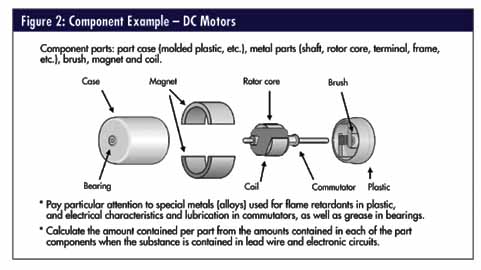

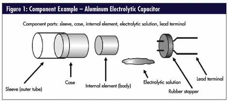

To illustrate the point, figures 1 and 2, taken from the survey and response manual of the Japan Green Procurement Survey Standardization Initiative, demonstrate the technical aspects of two types of components that must be analyzed and controlled to demonstrate due diligence. In both of these examples, it is up to the company's engineering team to understand the makeup of every component and whether it meets a directive's requirements.
