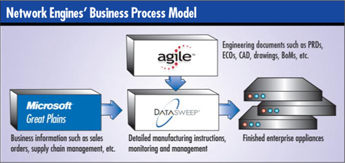

Network Engines relies on a manufacturing system built on a solid, integrated information infrastructure that provides the flexibility to address market shifts. In the interconnected system, engineers use Agile Software to create products, the manufacturing department uses Datasweep solutions to build and test products, and business administrators use Microsoft Great Plains software to input sales orders and procure supplies. Web tools on the front end convert the data into actionable business information for analytics and reporting. The system provides an open database scheme and the ability to activate manufacturing plant lines as needed.
Here’s a closer look at the three applications:
Agile Software. Agile Software provides the tools to create product designs and release them to manufacturing. It maintains critical product data such as manufacturing instructions, product requirements, bills of material and engineering change orders.
Microsoft Great Plains. Among other things, this application provides sales order and procurement information that allows the user to view material requirements by day, week or month, or in a bucketless format. Great Plains collaborates with finance on order approvals and then controls the submission of the work order to manufacturing. It also processes orders to suppliers, as well as finished goods inventory.
Datasweep. Datasweep’s solutions provide the manufacturing system and process control in order to build customized units correctly and on-time while retaining visibility into production status and key performance indicators throughout the process and across the supply chain.
One of the main reasons for Network Engines’ success is a flexible information technology infrastructure that has integrated these different applications. The Datasweep solutions are integrated with Microsoft Great Plains to seamlessly share and update business information on sales orders, suppliers, work orders and just-in-time inventory management. Datasweep is also a solution partner of Agile Software Corp., which achieved certification to the Datasweep Advantage suite for its Agile Interface product. With this end-to-end solution, Network Engines is able to design, build and track customized products across the entire product lifecycle.
