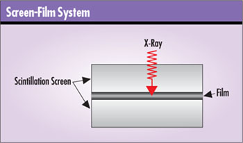

During the next half-century, X-ray technology--although constantly refined--didn’t change drastically. X-rays were emitted from a source, passed through an object and detected either on film or a fluorescent screen. Contrast and spatial resolutions improved, as did film speeds and control over X-ray sources. Scintillation screens were also used with film to achieve better images at lower dosage.
The next great advance occurred during the 1950s with the advent of the image intensifier. For the first time, clear images could be made available in real time. With image intensifiers, X-rays are picked up on a phosphor screen, focused down to another screen and then viewed either directly or via a high-quality television image tube or CCD camera. Despite image intensifiers’ great performance for real-time imaging, film remained the only option for large image size and good spatial resolution and contrast until recently.
Each of these technologies has its own set of drawbacks, however. X-ray film must be chemically processed, which often means about 20 minutes of lag time between an image’s capture and the technician’s inspection of it. If the film isn’t properly exposed or the angle is wrong, it’s a do-over, and another 20 minutes are lost. If multiple pieces of film must be shot, the time required to examine an object can run into several hours. Moreover, a company must have methods in place and employees trained to safely handle, store and dispose of film-processing chemicals. Notwithstanding film’s very good spatial resolution, it has a nonlinear and somewhat limited contrast range. Add to this the human eye’s limitations to discern no more than 100 or so contrast levels, and obtaining and examining--on just one piece of film--an X-ray of an object with a wide thickness or density range becomes nearly impossible.

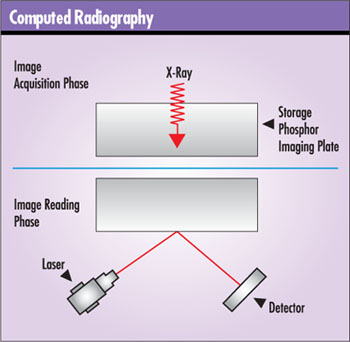

With the introduction of computed radiography during the 1980s, a giant step forward for X-ray imaging occurred. Until this time, the technology’s analog nature prevented any real automation. Inspection, defect recognition, sorting and the like depended upon human interpretation of film or image-intensifier images. Computed radiography offered the benefits of computer-aided image enhancement and recognition, the ability to store and transmit digital images, and the elimination of film processing and all its associated costs.
Computed radiography works similarly to film-based X-rays, but instead of X-ray film, a storage phosphor screen is irradiated and the latent image stored within it. It’s then taken to a reader, which uses a laser and detector to scan the latent image from the screen. In most cases this technology can be easily retrofitted into film-based systems, eliminating the need for film, chemicals, processing lab, equipment and storage.
The reduced costs in those areas mean a quick return on investment, says Fred Morro, Fuji Corp’s. director of digital radiography products for NDT (www.fujimed.com/ndt/ndt_fcr.html). “We do a cost analysis for each customer, looking at film costs, chemical costs and the cost of chemical disposal,” he says. “It depends on the application, but the ROI can be less than one year.”
Envision Product Design, developer of the CMOS digital flat panel (as illustrated below), estimates that recurring costs such as film, processing and chemical disposal reach about $6,000 per 1,000 X-ray exposures. This doesn’t include costs for film storage or a processing lab.
In terms of performance, computed radiography’s contrast resolution of 12 bits, or 4,096 contrast levels, rivals film, says Morro. And although its spatial resolution doesn’t yet surpass film, it’s more than enough for most NDT applications, he adds. Computed radiography readers for NDT can resolve 5 line pairs/mm (i.e., 100 µm).
Because of its high contrast range, computed radiography has the ability, as do all digital radiography technologies, to capture the entire density range of most objects in one pass, something that’s impossible with film. Computer manipulation then makes it possible to view just the density ranges of interest.
Like film, computed radiography screens can be cut or bent. Although the storage plates are more expensive than film--a 14 X 17 in. plate costs about $700--it can be used thousands of times, limited only by mechanical wear caused by handling. This makes it cheaper than film. Also similar to film, storage plates can be used--barring condensation or other moisture issues--for field X-ray inspection under extreme temperature conditions.
One advantage of computed radiography over other digital radiography technologies is that, in most cases, only one screen reader is needed to service an entire lab. The reader is separate from the screen and therefore not an integral part of the image-capture process. This could offer an advantage over other digital technologies, where image acquisition and the reader are integrated--requiring the purchase of an entire system for each concurrent use.
A disadvantage of computed radiography is that, like film, it isn’t real-time. Although faster than film processing, the screen must still be removed from the X-ray station and fed through the reader. Computed radiography represents a huge step forward and is still the prevailing nonfilm technology, but it can’t provide all the benefits of digital X-ray products.

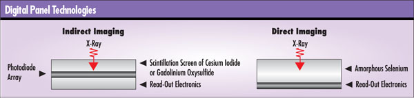

During the late 1990s, digital flat panels were introduced. Unlike their film or computed radiography predecessors, they provide digital readout of an X-ray image, making it possible to automate X-ray NDT inspection. Except for the fact that they can’t be cut or bent, digital flat panels are used in much the same way as film or computed radiography and can be left in place while robotic or conveyor systems bring parts to them or reposition parts for multiple views. The operator doesn’t have to change film or storage phosphor plates between shots, and the X-ray image is available seconds after it’s acquired, greatly improving on the productivity offered by film or computed radiography systems.
Currently, two digital flat-panel technologies are battling head-to-head for the market: amorphous selenium (a-Se) and amorphous silicon (a-Si). Outwardly, they both function in the same manner: X-rays are picked up by the panel, which converts them into a digital image that can be read from the plate. Because the panels require no processing, images can be obtained at rates of one image every few seconds up to live video speeds of 30 images per second. Because of their better resolution and increased field of view, flat panel displays with 30 images-per-second speed are ideal replacements for image intensifiers. However, depending upon the manufacturer, the 30 image-per-second frame rate may come at the cost of decreased resolution.
With amorphous selenium technology, X-rays strike an a-Se layer, which converts them directly into an electric charge that’s further converted to a digital value for each pixel. This is called a direct-imaging method. Proponents of a-Se say it offers better spatial resolution than a-Si.
With what are commonly called amorphous silicon panels (a misnomer because even a-Se panels use amorphous silicon), X-rays first strike a scintillation layer. This layer emits photons in direct proportion to the energy of the X-rays striking it. The photons are picked up by the underlying a-Si photo-diode matrix, which converts them to an electric charge. This charge is then converted to a digital value for each pixel. Because of the intermediate step of converting X-rays to light via the scintillation layer, this is called an indirect-imaging method. The scintillation layer is commonly composed of either cesium iodide or gadolinium oxysulfide, with CsI being the preferred material. Proponents of a-Si panels say they offer much faster frame rates, up to 30 images per second, than a-Se panels.
Both technologies offer near-film spatial resolution but with contrast ranges far exceeding film.

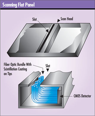

With all the buzz over a-Si and a-Se flat panels, some other flat-panel technologies might be overlooked but shouldn’t be, such as the CMOS X-ray. This interesting new product from Alaska-based Envision Product Design (www.cmosxray.com) is a scanning flat panel. It consists of a linear X-ray detector array and drive system housed within a flat panel 3 in. thick. The panels can measure up to 24 X 36 in. and are used in the same fashion as the ones described earlier.
With this technology, as the scanner traverses the panel (think document scanner), X-rays pass through a slot that collimates them before they strike the scintillating material. The material is deposited on the ends of a fiber optic bundle that runs the length of the array (see illustration to the right). In an arrangement that protects the X-ray-sensitive CMOS detectors from X-ray damage, the fiber optic bundle leaves the scan head at a right angle to the X-rays and connects to the CMOS detectors, which are housed beneath tungsten and lead shielding. The system can be built to operate with high-energy X-ray systems up to 10 MeV.
Alternatively, Envision sells CMOS linear arrays up to 6 ft long that can be fixed in one place while parts are moved past robotically or on a conveyor system. The image on this issue’s cover (minus the rider) was taken by moving the motorcycle in front of a 54 in. linear array. The 54 X 84 in. image took 110 seconds to acquire.
Envision flat panels and linear arrays have spatial resolutions of 80 µm and contrast resolution of 12 bits, or 4,096 gray levels.
Envision also sells a conventional 4 X 4 in. flat-panel CMOS array capable of 50 µm resolution and 12 bits of contrast.
