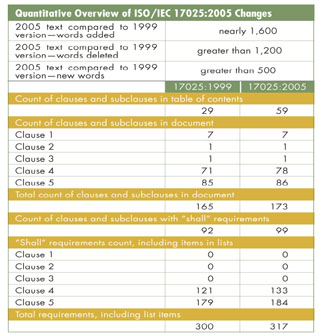

Users familiar with ISO/IEC 17025:1999, but not with ISO 9001:2000, might find the apparently large number of changes in ISO/IEC 17025:2005 overwhelming (as seen in the figure below). The best way to address this is to either compare the old and new versions of ISO/IEC 17025 to identify what really changed or obtain your accreditor's guidance on the changes. Users who aren't accredited could review the members list at www.ilac.org to find accreditors from their countries, and then consult these accreditors' Web sites for information, identify accreditors from Quality Digest's online database or simply visit the public pages at www.a2la.org.
