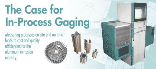

An example of an optical system designed for in-process inspection for aluminum extrusion is the Contur Projector from DII ASCONA. In the case of an extruded part, the entire cycle of preparing a sample and performing a dimensional measurement for, say, 75 measurement points, can be fewer than 60 seconds. Pass/fail feedback is provided to the extrusion team and all data are captured automatically on the network for statistical process control or customer-reporting purposes.
The nature of extruded part manufacturing, in which a piece of the extrusion must be cut off and prepared for measurement, precludes an automatic or closed-loop system. However, the dimensional results feedback enables an operator to take corrective action, such as stopping the press. Stopping the press and pulling the die can reduce scrap by as much as 90 percent, in addition to avoiding lost press time, which could amount to hundreds of press hours per year.
