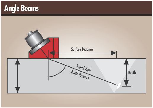

Angle-beam. The angle-beam method has to do with the type of transducer used. An angled sound path can be used to better detect flaws within a material. This is explained further in the next section.

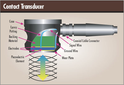

Ultrasonic testing relies on the transducer used to emit sound. The ceramic piezoelectric transducers generate electrical impulses and change them into acoustic energy, and vice versa. “They create mechanical wave forms that go through the part and change the returning pulse echo from mechanical back into electrical so that the scope can read it,” says Culbertson.
There are two major types of transducer: contact and immersion. Contact transducers, as illustrated on page 31, utilize a coupling material, such as water or oil, to smooth rough surfaces and prevent air gaps from manipulating the results.

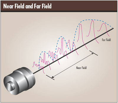

Culbertson. “With a transducer you can’t inspect in the near field. With an immersion transducer, you use water to differentiate the near field and the far field.”
The near field is an area of space in which the sound waves are not uniform. The ultrasonic beam is more uniform in the far field, where the beam is spread out in a pattern originating from the center of the transducer. The variations that occur in the near field eventually change to a smooth and declining amplitude, at which point the far field begins. (See page 32.)

Angle-beam transducer. This transducer can be either contact or immersion. Shear wave is anything other than zero degrees. For example, if you’re thickness testing, you go straight into the part. An angle beam will measure at different degrees. “It’s used when you’re looking for defects that are neither parallel nor perpendicular to the part,” notes Culbertson.
