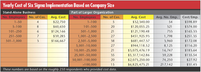

In our past two Six Sigma surveys, our panel of Six Sigma experts have pointed out that Six Sigma is generally most successful in larger companies because of the cost of implementation; most experts believe that a successful implementation requires at least one full-time Six Sigma practitioner. Add training or consulting costs and employee hours lost to training, and the money-meter gets whirling pretty fast. Although evidence indicates an almost guaranteed return on investment, the start-up costs may be beyond the reach of small companies. This year’s survey corroborates that possibility.
About 250 of the 935 respondents who have implemented Six Sigma shared with us how much their company spends on the program per year. This includes training, consulting and the salaries of full-time Six Sigma employees. We broke the responses down into two sets: one for stand-alone businesses--those not part of a larger organization--and one for those that are part of a larger organization. The number of responses for the first set is small (a clue in and of itself), but the data point to an average of about $75,000 per year. This figure could be smaller if you subtract the two or three companies that spent considerably more on Six Sigma than the others. Although this might be a reasonable figure for companies with several hundred employees, it’s a bit of a financial reach for smaller companies.
It’s interesting to note that these figures are roughly equivalent for companies that are part of larger organizations. Because training costs are based on the number of participants and Six Sigma generally requires a percentage of employees be directly involved, there’s a direct correlation between the number of employees and the cost of implementation. Roughly speaking, for companies with 100 to 50,000 employees, the cost of Six Sigma implementation is between $100 and $200 per employee, according to these figures.

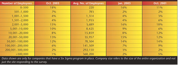

Since our first survey, Six Sigma has made some progress into small businesses, which we defined as organizations with 500 or fewer employees. In 2002, only about 11 percent of companies that had a Six Sigma program in place had 500 or fewer employees; today the portion is 18 percent. The majority of these sites, however, are part of larger organizations, indicating deeper pockets and the ability to support the program.
That said, many consultants are developing training materials or off-site courses that are more cost-effective for small companies. In addition, some small companies are implementing Six Sigma without using a full-time Six Sigma practitioner--one of the major ongoing costs for implementation.

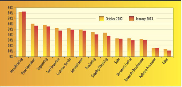

Six Sigma programs are also making their way into their organizations’ nonmanufacturing functional areas. Although the percentage of respondents reporting that manufacturing use of Six Sigma has remained the same, at about 82 percent, almost every other functional area has shown a 3 to 5 percent increase in Six Sigma use.
Distribution of Six Sigma Programs by Functional Area

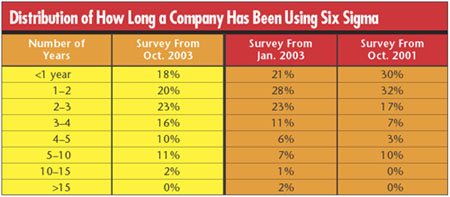

As in previous surveys, we continue to see a dramatic drop-off of companies using Six Sigma around year three. Last year we postulated that this could be because after three years, companies had reaped the predominate benefits from Six Sigma by picking the low-hanging fruit--obvious waste or productivity issues--and then lost momentum later when the dramatic savings of earlier projects failed to appear. But with only data from two surveys to consider, it was difficult to make a solid conclusion that this is the case. With this survey showing the same drop at year three, it’s becoming more apparent that many companies are abandoning the process at that point for some reason.
Strangely, although we see Six Sigma making it’s way into small companies and nonmanufacturing areas, as a whole, there are fewer companies starting Six Sigma initiatives. We define a Six Sigma start-up as a company that reports its Six Sigma initiative to be less than 1 year old. In 2002, 30 percent of respondents reported using Six Sigma for less than one year. In January of 2003 the percentage dropped to 21 percent, followed by 18 percent this year.
In addition, there is an interesting trend developing with respect to the percentage of companies within each year range across the three surveys. The percentage of companies in years one through three of implementation have dwindled each year, while the percentage in years four and higher have increased. This trend suggests that the Six Sigma market may be peaking or has peaked. However, as with last year, about 50 percent of respondents who haven’t already implemented Six Sigma said that their companies plan to start the program within the next 18 months. Next year’s survey will give us a better indication of how the Six Sigma market is progressing.
Distribution of Company Size for Sites With Six Sigma

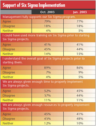

As any Six Sigma practitioner will attest, for the process to work it must have complete buy-in from the top down. For the most part, our survey reflects this.
Nearly 80 percent of respondents agreed with the statement that “Management fully supports our Six Sigma program,” with 40 percent saying that they strongly agreed.
Respondents also indicated that the goal of Six Sigma projects is well-understood prior to commencement, with 87 percent agreeing that was the case and 7 percent disagreeing. Because Six Sigma projects are bottom line-driven, this is a significant figure and indicates that management and practitioners are doing a good job of identifying and communicating project goals and parameters.
The scores lag somewhat, however, when it comes to the nuts and bolts of support (e.g., training, time and resources). Nearly 41 percent of respondents indicated that they could have used more Six Sigma training prior to starting Six Sigma projects; about 45 percent indicated training was adequate. The score was also split when it came to the amount of time allowed for Six Sigma projects: 51 percent responded that they were given enough time, 37 percent said they weren’t and 11 percent were neutral. Availability of resources showed an almost even split, with 45 percent agreeing they had enough resources to implement projects and 43 percent indicating they did not.
