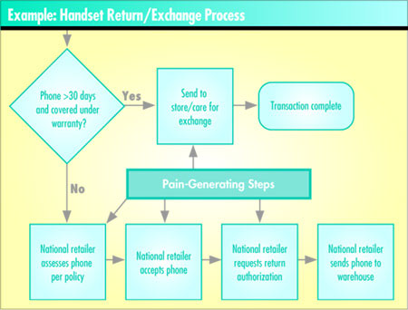

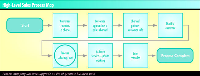

Through process mapping the entire sales cycle, a Six Sigma team determined that the greatest opportunity for reducing CPGA lay in the costs of upgrading and replacing customers’ malfunctioning handsets, as illustrated on page XX. The team zeroed in on the upgrade and exchange process, uncovering key areas where problems were likely to increase costs in returns and exchanges (See the figure on page XX).
At this point, the team applied Pareto analysis to identify process capabilities and develop a program for improvement. The team broke return/exchanges into three classes based on whether the return occurred fewer than 30 days after the sale, more than 30 days to a year after the sale, and more than a year after the sale. The information allowed them to pinpoint improvements in each of these circumstances.
The improvements included working more closely with the handset manufacturer, working with retailers to improve their internal processes, insisting on compliance with a return/exchange policy, automating some key processes to eliminate errors and reeducating customers on how best to handle problems with handsets. As a result of these efforts, the team reduced more than $236,500 in expenses annually.
