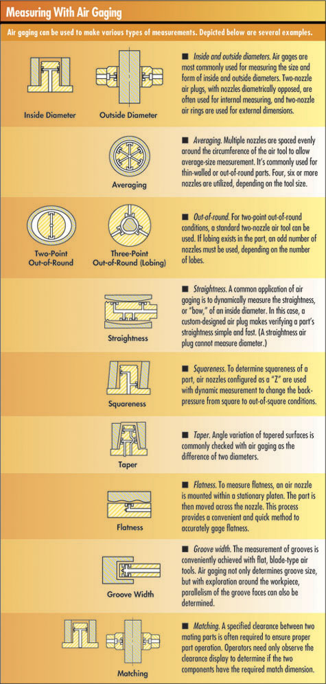

As this article explains, air gaging is ideal for measuring dimensions with tolerances smaller than 0.005 in. When gaging tight tolerances, resolutions as small as 0.000002 in. can be achieved. Its noncontact characteristic makes air gaging particularly useful for checking soft, highly polished, thin-walled or other delicate materials.
Air gaging’s benefits
Chief among the benefits of air gaging is its ease-of-use, which helps produce accurate results even when performed by unskilled employees. Operation is as simple as presenting a tool to a workpiece and observing the reading. Speed is another benefit: A row of multiple-column amplifiers can be scanned in one glance, reducing time and fatigue. Moreover, relationships (e.g., squareness) that cannot be checked by fixed-limit gaging--and are costly to do by other means--are easily measured with air gaging.
Air gaging is also economical. Once the basic system is purchased, relatively inexpensive additional tooling can be used for a wide variety of applications. Air gages effectively measure all common types of dimensions and are particularly suited for measuring dimensional relationships and match gaging.
Most air gaging systems operate at air pressures that can purge workpieces of contaminants (e.g., abrasive particles, coolant, etc.) at the measurement point, eliminating the need for separate cleaning in most operations. And, because air gage tooling has no moving parts, it’s virtually immune to fouling. Air gaging offers a wide choice of tooling for single or multiple measurement applications, and when repair is needed, air tools are simple to fix.
