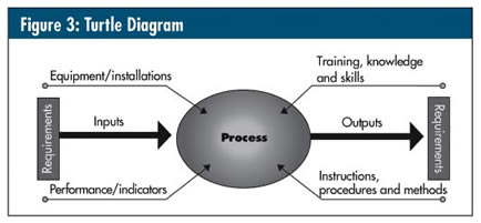

Turtle diagram
The starting point for ISO/TS 16949 is to understand your organization's existing processes. Under QS-9000, many people came to understand the basic process model. (See figure 1.) This model can be seen in any activity and represents a balance of energy going into a process and coming out. If you don't have a balance, waste is present in the process.
By understanding the basics of any activity through the process model, you can start looking deeper into what is happening in your organization. Six Sigma practitioners have expanded the process model to get the supplier-input-process-output-customer (SIPOC) model. (See figure 2.) This includes recognition that every process has customer(s) and supplier(s). Sometimes organizations change, and processes that were at one time important are no longer needed. The challenge is to determine if your current processes still add value to your organization and its customers.
Under ISO/TS 16949, we now move to what is called the turtle diagram for individual processes. (See figure 3.) This takes the basics of the process model and adds aspects of the SIPOC to what is being done in the process to satisfy customers. Internal auditors must review these diagrams for every major process in your organization. If the internal auditors don't find such diagrams, they will have to create them as they go. (Remember to leave a copy in the area for the next auditor.) Some say that the turtle diagram is a cross between the SIPOC and a cause-and-effect diagram. This is a good analogy because the turtle diagram looks at how the process satisfies the customer (typically an internal customer at this stage). By looking at what is really happening vs. what procedures say is supposed to be happening, an evaluation can be made as to whether the process is effective in meeting the customer's requirements.
