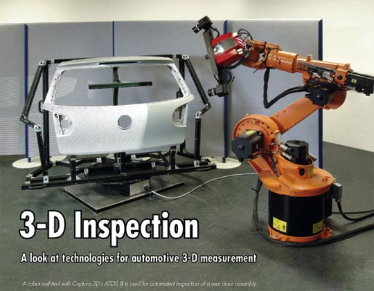

A robot outfitted with Capture 3D's ATOS III is
used for automated inspection of a rear door assembly.

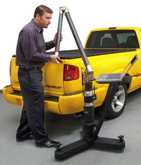

Articulating arms
The most recognizable of portable 3-D measurement devices are the articulating arm coordinate measuring machines (CMM) manufactured by such companies as FARO Technologies Inc. and Romer Inc. (a Hexagon Metrology company).
These are manually operated instruments consisting of an up to 7 ft "arm" (a roughly 14 ft measuring envelope) that pivots at the wrist, elbow, shoulder and base, allowing a probe or laser scanner at the end of the arm to reach almost anywhere on the part being measured. Encoders at the pivot points report the angle of each joint and thus the location of the probe tip in 3-D space. The entire arm and base can be easily moved to anywhere on the shop floor and set up in minutes. It's also possible to position the entire instrument at multiple locations (i.e., "leap-frog") around a very large part and stitch together the data collected from multiple setups to extend the measurement volume.
A disadvantage of arms is that they require an operator to move the probe to each location on the part to take a measurement.
The accuracy of arms has increased tremendously over the years. The most accurate FaroArm has a published single-point accuracy of 5 µm; Romer's will measure to 4 µm in the single-point sphere test.

In the previously discussed technologies, we noted that a certain amount of manual intervention is required. Structured white-light systems, on the other hand, can be mounted on robots or other motion-control systems, allowing automated part inspection. In that particular case, a rotating fixture (or robot arm) holds the part to be measured. Targets on the fixture are used as reference points. The part is rotated in front of the scanner, or the scanner is moved around the part.
Capture 3D and Accurex Dimensional Measurement are two structured white-light vendors that will appear at this year's CMSC show. Capture 3D utilizes the Advanced Topometric Optical Sensor (ATOS) scanner manufactured by GOM mbH in Germany for its 3-D shop floor solutions. Accurex provides systems produced by Breuckmann GmbH, also located in Germany.
Both systems claim accuracies down to about 15 µm, although accuracies are dependent on lenses and distance from the part. One Capture 3D customer reports having achieved 75 µm accuracy over a 23 × 2 × 2 ft volume.
