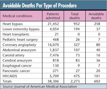

Everyone knows that major defects exist in core areas of health care, and that these defects cost not only dollars but human life. For example, medication errors are the second most expensive type of malpractice lawsuit, averaging $163,090 per claim, according to Shulkin's 2002 presentation titled, "Developing the Role of the Patient Safety Officer." It's easy to understand why this is the case: just look at the way many prescriptions are communicated between medical professionals (e.g., doctor to nurse, doctor to pharmacist). In the table at right, the left column lists a common and more error-prone method of presenting prescription instructions; the right column shows the unambiguous, less error-prone method.
More evidence that medical practitioners are turning a blind eye to root causes based on error can be found in statistics on avoidable deaths per type of procedure, as seen in the table below.

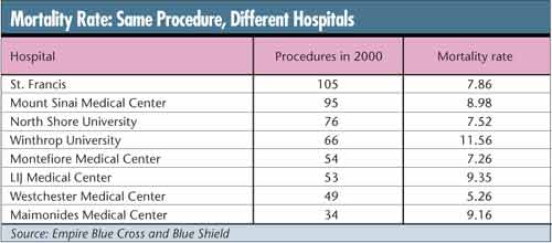

"There are real life-and-death differences between hospitals, and that shouldn't be ignored," Dr. R. Adams Dudley told the San Jose Mercury News in 2000. Dudley is an associate professor of medicine and health policy at the University of California, San Francisco, and the author of "Study: Choosing the Right Hospital Can Be a Life Saver" (Journal of the American Medical Association, 2000).
But don't just take his word for it; you can perform a simple ANOVA test to statistically prove the validity of that statement. Even that may not be necessary. The data in the table below, a sampling from several hospitals for the same procedure, indicate that perhaps there are obvious, even blatant, differences.
Working with doctors, we used Six Sigma tools to analyze the data from each of the fatalities and determined that the rate of avoidable deaths could have been reduced by more than 50 percent.
