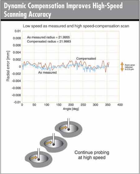

Renscan5 provides far greater capabilities than the company's existing dynamic compensation technology. That product, RenscanDC, enables CMM users to measure at extremely high speeds, but with accuracies that previously could only be achieved at low speeds. RenscanDC is based on error-mapping the dynamic errors when measuring component features. These dynamic errors are normally repeatable. Scanning a feature first at low speed and then at high speed allows dynamic errors to be determined and a dynamic compensation map to be computed. Only one sample component from a production line needs to be scanned at the slow speed to generate the dynamic error map.
The correction data are saved and automatically applied to subsequent parts and batches, which can now be measured solely at the fast speed. The figure above shows the improvement in high-speed scanning accuracy by applying the compensation. RenscanDC is part of an optional scanning plug-in for Renishaw's universal CMM controller (UCC).
