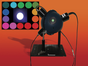

LED Technology Proves Useful in Color Calibration
In the world of color measurement calibration, technicians have typically run into problems finding a specific wavelength for blue light. Because traditional light sources such as incandescent lamps are thermal, a blue thermal source would need to function at such a high temperature that many components would melt.
To alleviate this predicament, the National Institute of Standards and Technology has developed a “rainbow source” that can be tuned across the entire visible light spectrum, from red to blue light.
A lack of blue light sources introduces uncertainty when calibrating instruments that measure the color of things like bright stars or the open ocean. Knowing exact colors is important because, for example, it allows scientists to use remote satellites to judge the concentration of plant life in the ocean--which, in turn, affects global climate.
The rainbow source utilizes advances in light-emitting diodes of different colors. By mixing exact percentages of LEDs at different wavelengths of visible light with the desired brightness, the optical properties of the source (such as the color) can be changed and tailored for a particular application. The sources use commercial LEDs.
NIST researchers characterized these LEDs and developed the packaging, electronics and software. In addition, the tunable light source is portable--comprising a sphere of 30 cm in diameter that weighs about 5 lb. Battery-operated versions have been developed for field applications.
The National Oceanic and Atmospheric Administration has ordered a simplified version to reduce uncertainties in calibrations of a satellite that measures ocean color, as part of a program that monitors the carbon balance between the ocean and atmosphere.
More details were presented at recent InterSociety Color Council and Council for Optical Radiation Measurements meetings.
For more information, visit www.nist.gov.
